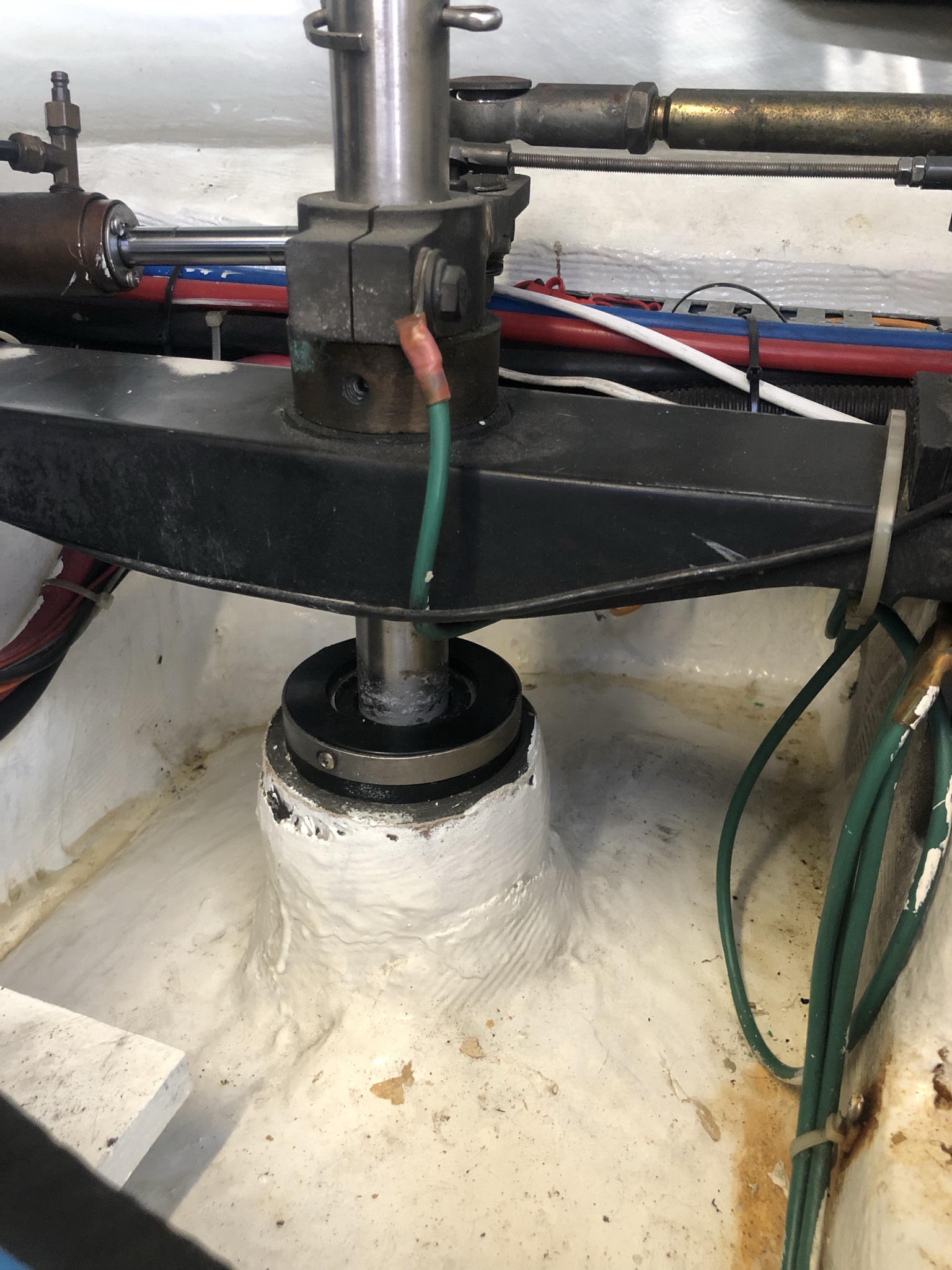

    F1AAC1BE-AF4B-472D-97CD-E6FE6A57D125.jpeg 14E39C3E-7432-40B4-9EE7-D34AF70C2F67.jpeg
    ok I don’t know why I had these but it accidentally shows rudders. Does this shed any light on a diy fix for small leakage while underway?

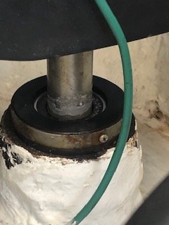

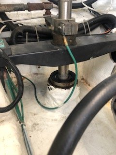

    So here are some better photos. Any suggestions? 99F6D850-5E80-4F90-9BF0-F1696D3313DE.jpeg 889DF60A-1670-4641-A612-ED426C190B14.jpeg 2C4A6491-A95C-4524-A165-E5451A0D0459.jpeg
  6. mapism
    mapism Senior Member
    Aug 9, 2008
    2,116
    Sardinia
    Looks like you have some kind of lip seal, working directly around the rudder shaft surface, which appears to be a bit corroded.
    So, to answer your OP question, if the seal is working on a corroded shaft surface, any seal tightening (which btw I don't think is possible, judging by your pics) would be pointless.
    Worth pulling the rudders out and check the shafts carefully, I think.
    If the corrosion is superficial enough, clean them very well and replace the seals.
