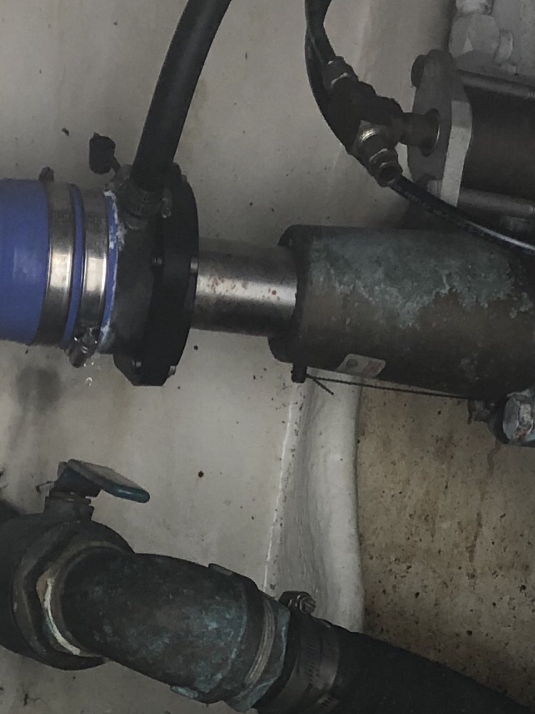

    Hi everyone, hope you are all having a great summer. We just completed a 300 mile, around Long Island cruise. Our Convertable 38, Cat 3126’s ran great. The day after our return, i see we have a port side shaft leak. Any advice before I pull the boat and replace the seal? Thank you in advance!

    Assuming they’re 7+ years old... Replace the entire shaft seal assemblies on both sides. And check shaft alignment and cutless bearings.

    ....and add several spare seals into place so that you can refit in the water.

    Might only be room for 1 spare, but that’s better than nothing. I think. Anybody ever used a shaft mounted spare?

    Yes. But it's generally mounted in a separate carrier, which I don't see there.

    For that last use, try cleaning the seal. All apart you will take on some green water but it will rinse the seal area of crud.
    If not do able or does not fix;
    Then it is time to replace the seal.
    We have done this with out pulling the boat but is a better job on the hill. Coupler has to release the shaft.
    There is room for a few spare seals in their protective carriers. If you have to replace this seal, consider stacking a few spare 1 piece lip seals.

    A dive mask and a bit of plumbers putty around the stern tube will make the whole job much less stressful.

    If going with new dripless seals, the selection of replacements with dual ports will permit operation with one disabled engine.
    The installation of dual port dripless seals on engines with lift mufflers requires that the water will drain overboard on the disabled engine, instead of backing up into that engine. Verify the heights of the drain path being lower than the engine path.
    The rotational orientation of the ports must comply with the documentation.
    The dripless seal requires two periodic tests. Disconnect the port hose and cap. One test is to operate the engine and verify sufficient cooling water flow, per the spec. The other is to uncap the port and verify unimpeded water ingress.
