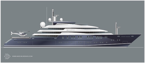

    M I S T Y , 75 m / 245´
    On "request" from our fellow member René GER, who wanted to see a yacht in the 60-80 m range, I have made a smaller version of the 85 m Modesty. She is 75 m and is then called Misty. All of my designs with these straight decks can be made both longer and shorter without losing too much of it´s original character.

  7. Rene GER
    Rene GER Senior Member
    Sep 4, 2004
    739
    Northern Germany, West Coast
    Hi Lars,
    I thank you so much for the "Misty".
    Do you can tell me, what is the better heli deck:
    - A heli deck like that on the "Misty", "Ilona", "Octopus"...
    Or
    - A heli deck that higher is. "Lady Chistine", "Skat", "Lady Moura"...
    Helicopter's on yachts are very interesting for me.
    From the view of the space on a yacht... I think a higher heli deck is better. For the design too (my opinion).
  8. AMG
    5,392
    If you think of it from the Heli-pilots view, it is better with a deck that is lower down and in the stern so that you can make an approach with the yacht as a reference of altitude in front of you and a low deck is moving less sideways as well. As Misty and Ilona with a garage under the pad, it is also better to have it low in the stern, or on foredeck, but there instead you will have a problem to land if the yacht is underway.
    However on Gigayachts with wide beams you can land pretty safe even on higher decks as the margins are larger and the boat is less swinging.
    You can also make a helideck on top deck more or less invisible and if you are not carrying your own helicopter this is probably the best for the look of the yacht.

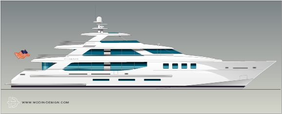

    Chianti II, at 50 m/164´the most popular size?
    The 50 m size is probably the epitome of a Superyacht, big enough to go anywhere and still not bigger than you are welcome in most ports. This particular yacht is presented with all deck plans in another thread on the YachtForums http://www.YachtForums.com/forums/showthread.php?t=1627 but I have given her a more (modern?) edgy profile now.
    In the book The Superyachts 2005, I found that there are no less than 78 Superyachts between the 49 m Oceanco-built Netanya and the Feadship Rio Rita at 51.99 m LOA.
  14. hufloas
    hufloas New Member
    Dec 1, 2004
    48
    Gandia (Spain)
    Amazing! "Electric blue" windows beautifully contrast with white hull and superstructure "a la Feadship" :cool:
    Congratulations, Lars! ;)

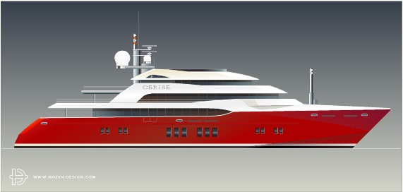

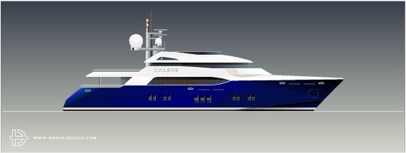

    Meet Cerise and Calege...
    "On demand" the 160´ Cat design has now been remodelled to a 180 feet monohull expedition style yacht and the 120´Cat to a 135 feet yacht. Both will be quite beamy and with the extensions the interior volumes will remain about the same as with the catamarans.

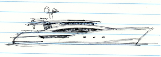

    With regards to bubble-design, I have tried to make something of the kind, but eventhough pretty simplified they have not made it to the computer yet. This was made in a notebook and the bubbliest I have been so far... :D
    /Lars
