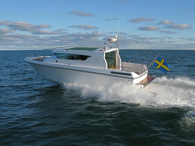

    Just in time for the Scandinavian Boatshow in Stockholm, our new 34-footer was launched. We started this project seven months ago which is a rather short time for a new model, but the first sea trial across the Baltic was successful. The top speed was 38-39 knots with a Volvo Penta D6 370 hp and she was using around 1,6 l/nm at 30 knots.

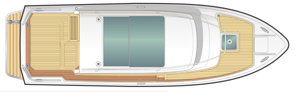

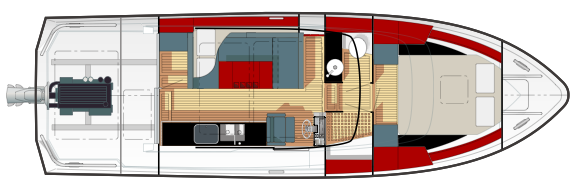

    Here is the final arrangement of the D34:

    CONGRATS on the launching of your new 34-footer.

    Thanks Arnie, it is always a relief to see the boat floating on it´s marks and performing as predicted...:)

    Congratulations Lars! She looks really good afloat.

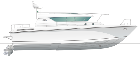

    As I mentioned in my PM Lars, thats a downright good looking boat there. :cool:

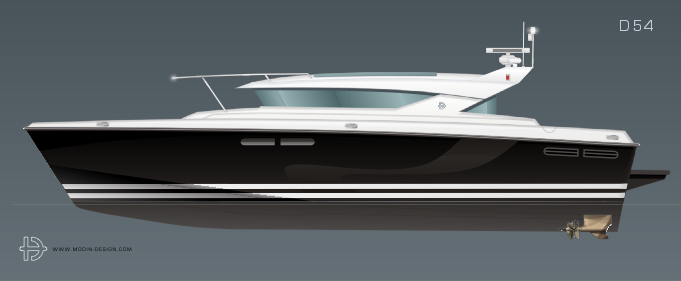

    Thank you, I have to wait some time before I can show you the complete boat, but here is the present profile in another colour scheme. More on this boat will come in February in connection with the Stockholm Boatshow. The real thing is planned for the 2010 season.

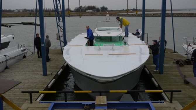

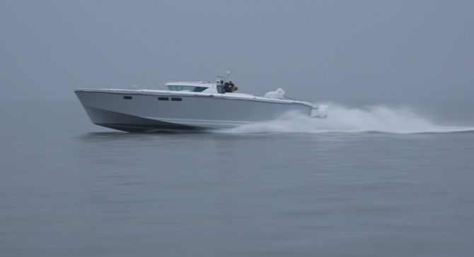

    OK Speedy, this thread has been quiet for some time now, partly because we were waiting for the first D54 hull to be launched and tested.
    Since we were going straight from drawings to full scale sea trials it was a very exciting day when the builders, Volvo Penta representatives and us behind the design saw it rolling out.
    This first hull had a complete D29 fitted inside to give comfort and weather protection for the test crew, the Baltic is a dull place this time of the year...
    We had an idea that twin IPS/600 could give acceptable performance, eventhough we had installed triple IPS in this hull, so we started with just two engines running. This was not very successful, but we got about 32 knots. This can most likely be improved with just a clean twin installation.
    When we later adjusted the ballast trim and was running all three engines, the performance was a lot better. No big hump to get on plane and almost 42 knots speed, with very little wake.
    So with the hull in place, we can now focus on building the deck and interior. We hope to have the first complete boat in about six months.

    that last pictures looks kinda odd :D that small windows on such a big yacht *lol*
    but in that you see how big that boat really is...
    looking forward for the first complete pictures and interior pictures :)
  20. EnigmaNZ
    EnigmaNZ Member
    May 8, 2006
    38
    New Zealand
    It does indeed. In case people aren't aware. The 54 foot hull being tested is a bare hull with engines fitted. The cabin you see is actually a separate 29 foot boat sitting inside the bigger hull providing the test crew with some protection from the elements and controls etc. They must have set some sort of record as having the largest lifeboat as a proportion of the primary vessels size i.e. a 54 footer with a 29 foot lifeboat.
    Looking at the center picture, I am surprised that the D29 is so off center in the D54's hull. That must affect the balance of the larger boat.
