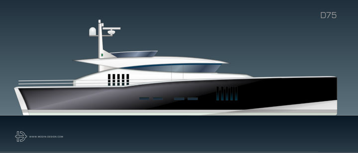

    This may not be a good comparison but I can’t think of a similar purpose yacht right now, and personally I like your masculine design better.

    That sounds very promising with an instant "edge" over the competition, that is if there is any.
    But one must wonder if such a weight saving (on the D75) will have a negative effect on the boat's seaworthiness in heavy seas and stability.
    *just rambling, as I'm not a naval architect.
  4. AMG
    5,392
    Not at all, but as I said it is a little more challenging driving on top of the seas at high speed, compared to going through the waves at lower speeds. But the idea with the D75 design is to be able to do both, the narrow bow will split the waves in lower speeds and should be lifted above in higher speeds. Remains to be seen of course, but you get a hint of it if you look at the modern fast sailing boats.

    It is good to leave a design for a while and see if it can be improved. This version has now been tweaked almost everywhere, but still retains most of the original idea. I will try to make it as a 55 foot version as well before deciding on the 50-footer I have started with. It makes more sense to have a similar design style on both of the coming boats I think...

    I do like the bold look of the front half. Not so settled on the back half. Though this may be one of those cases where a perspective view would give a better presentation?
    Kelly
  9. AMG
    5,392
    Kelly, if it isn´t good in 2D, no 3D rendering can make it better...:eek:
  10. KCook
    KCook Senior Member
    Jun 24, 2005
    1,159
    Phoenix
    Sorry, I cannot agree on that. A profile gives no hint as to the beam. And a wide beam can give breathing room to a design that may be out of tune on a narrow beam.

  11. AMG
    5,392
    You are right in a way, another view can make it worse, but not better....

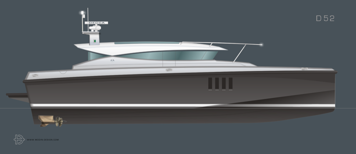

    D52
    Here is a first rendering on a modified D50, now reminding of the D75. It had to be extended to 52 feet as this hull is more narrow forward. Perhaps the interior volume will be like a normal 48-footer and seakeeping like a 60´...:)

  14. Yacht News
    31,104
    Do I see Penta Drives Lars?:)
  15. AMG
    5,392
    Yes, I will adapt the hull to the IPS II/900 if nothing better comes up...

  18. atomare
    atomare New Member
    Jul 25, 2008
    58
    Duisburg, Germany
    Hi Lars, if I may call you so? ...
    First of all, I really enjoy your designs,... from a styling point of view, your style of presentation and the fact, that you share your process with us.
    As for your D52 concept´s hard top, I would like a combination of what you show in post #153 and the third concept of post #157, a roof that seems to be floating above the windows, but visually interlocks with the hull structure, that is moving up. It gives a nice, dynamic look to the profile... What I would do is use the shape of the roof of #153 and interlock it with the hull like #157, but in the reverse direction to generate a more dynamic expression to the front and a relation to the bow line that is coming out of the water.... I also think you might have to adjust the proportion of the portholes more to the actual size of the yacht. I would expect a proportion like that on a 60m yacht, but here this ends up in portholes like 20cm wide and 80cm high? ... It might give a slight impression of prison bars from the inside? ... Don´t get me wrong, I love your designs and also this one, I´m just trying to give some constructive criticism. ;)
    keep designing... best of luck, David.
