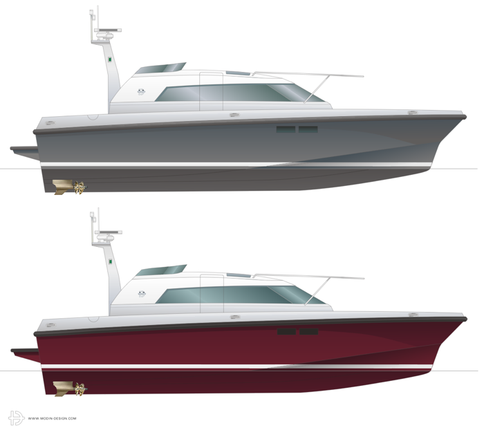

    For the coming 50-footer I have considered to use the "grey-line" design I showed in my first thread on YachtForums in 2004. It is hard to know if this design would be better received on a 50´ than using the reversed windscreen design as on the D34 above...?
    What do you guys think, will this design be the right for a 2010 50-footer?

    have you tried to design the grey design with a reversed windscreen? i think that could look very cool - maybe you'll have to stretch the roof a bit forward but that would give some head space too

    Thanks Jannick, maybe you are right, I´ll give it a try.
    Codger, this is why I am hesitating, a production boat for about € 1 million must be appealing to enough people before we invest in all the tooling. The workboat style windows are not what you find from other builders why people may not be prepared to buy them..?
    Since I can not use a stepped hull for the IPS, I was looking into this design instead, but perhaps I can still make a reversed windscreen. We´ll see pretty soon..:)

    My opinion, the name of the game is to be contemporary and different. That is why Apreamare has changed style further. There are too many design with raked pilothouse windows. Your design might bring some new flair and attraction.
  8. AMG
    5,392
    Yes Nilo, it is just a matter of how different you dare to be...:)
    As an example, Fjord made a 40-footer that reminds quite a lot of my "Greyline". It has received attention and design prizes, but I don´t think they sell very well? At least not compared to our 40-footers. So maybe I should continue that style, it is just that it becomes a little boring doing the same lines after six years...;)

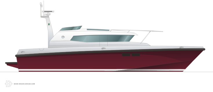

    I made a quick attempt of reversing the windscreen of the boat above but then I had to change the bow since it looked too strange. I already have a "white" 50´prepared that I will not show yet, but I think it looks better than this one...

    I do like this latest bow profile much better than the prior Fjord-like one.
    As for the windshield direction, I think your version of the reverse slope is successful because it is not tall (trawler like) and you also take great care with the modeling of the surfaces below and above the windshield. Wordy way of saying it works very well. A conventional backward slope also works. Ideally offer the customers their choice of either style????
    I know the Scandinavian idea of style is to have a very clean line, even severe by some tastes. But ... the area of the latest design that concerns me is the aft shear. It's, err, boring. By pedestrian standards it could use a kick, or vent, or some sort of design flair. Think Italian?

    Kelly, your observations are right, there has to be some surrounding support lines with a reversed windscreen to make it look OK. The transom is open with a hatch covering the cleats each side. Not much space for additional design features. And in fact, my design was presented to the guys building the Fjord, long before they started with their new line...:cool:

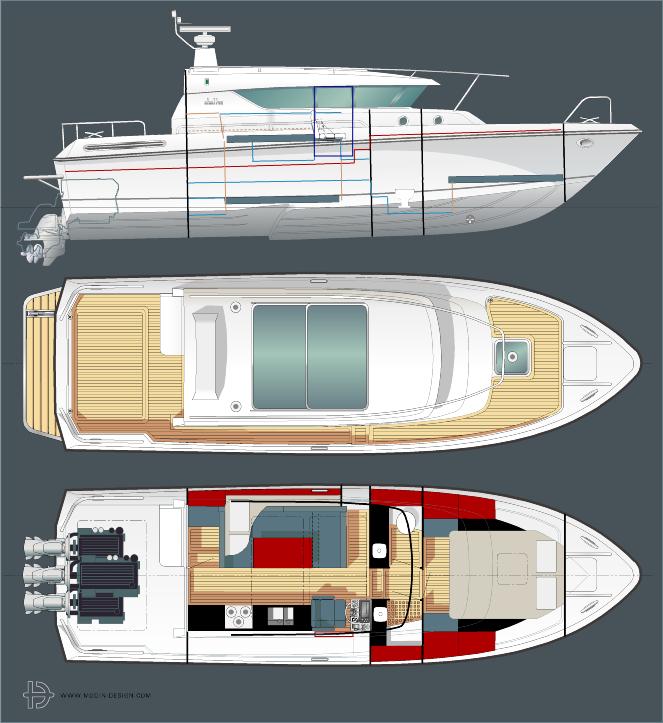

    The Seavee 390i IPS have 22.5 deg. deadrise and are without recesses.
    Tripple V8 gasolines will be perfect in the new 49ft SC runabout;)
