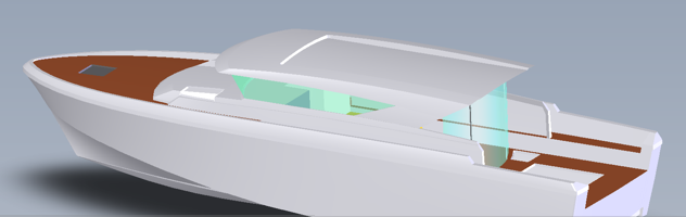

  7. AMG
    5,392

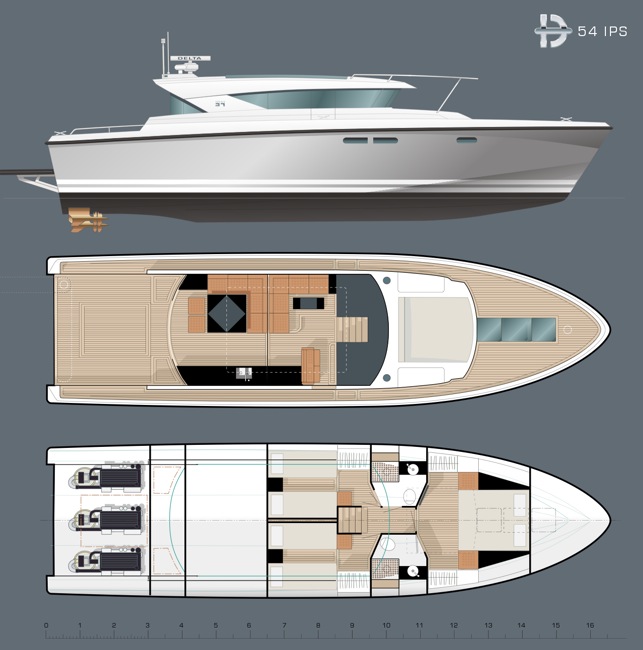

    This year is soon coming to an end and the same goes for this thread. It has been a busy year for me and I have not been posting much news here, but soon I can show the final arrangement of this 54-footer. Meanwhile, here is a picture from when we tested out the hull, with the deck now superimposed..:)
  8. Yacht News
    31,104
    Really looks performance!
  9. AMG
    5,392
    This is the General Arrangement of the D54 as now decided on. The aft deck is on the same level as the aft part of the saloon, with the forward area a step up. Down below are two twinbedded guest cabins and a master with a double bed and there are two bathrooms. Pretty straightforward layout.
    All is built with light-weight materials, on teak laid carbon decks. Plugs for the superstructure is now under construction and all will come together piece by piece during the spring...

    Is that a sky light along the forward centerline for the twin guests or master? directly below?..almost WallyPower 118 in that respect...
  11. AMG
    5,392
    Well not exactly, this is an escape hatch in the master cabin and a hatch to the forward storage, with a skylight in between...

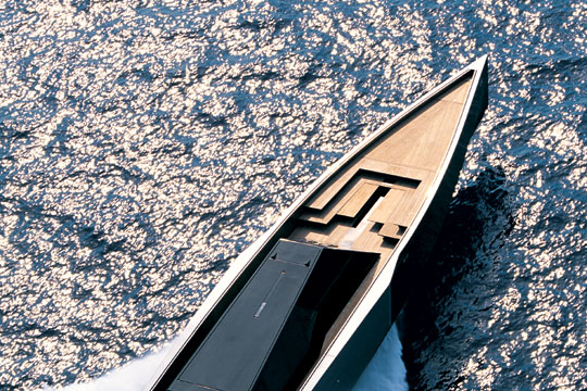

  12. Yacht News
    31,104
    Oh I see, but you can see why it conjured WallyPower 118 though Lars?
    img_118WP_new_004.jpg ​
    Wally
  13. AMG
    5,392
    I am not that sophisticated, I am just buying the kit from Lewmar... ;)
  14. Yacht News
    31,104
    The flush hatches look good from them, no doubt it'll look great on the 54. This is the way to go, of course this is where the industry has gone, for quite a few years now. Raised hatches seem to be a thing of the past now.

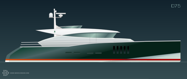

  18. AMG
    5,392
    I like a later version of the 75 better than the one you posted; http://www.yachtforums.com/forums/62478-post145.html
    Anyway, what you get with a boat this size is two full decks, on the 54 we still have to consider where standing height can be obtained on the lower deck.
    When we tested the 54 hull, she performed well in all speeds, the hump speed was between 15 and 20 knots, never with more than 3 degrees trim and between 30 and 40 knots, she stayed at 1,5 degrees trim. At ten knots, (1250 rpm) she had a 1,5 degree trim as well which means very little wash.

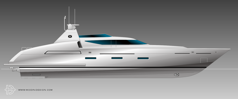

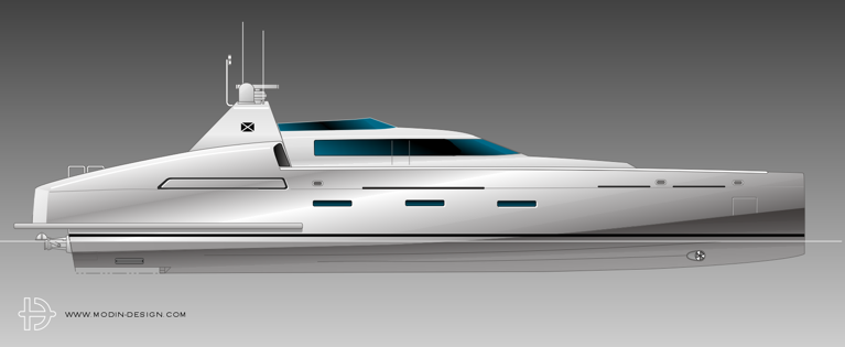

  19. AMG
    5,392

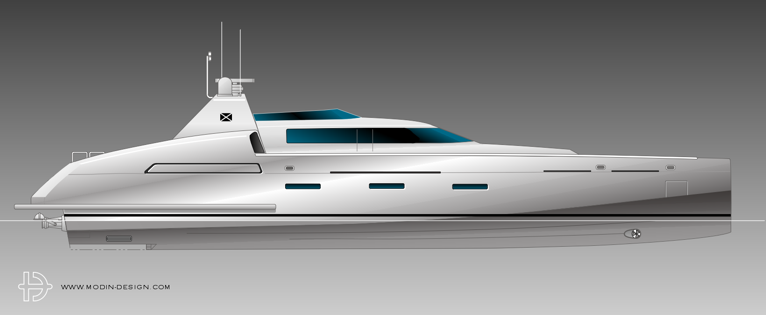

    On the topic of bow and transom angles, I was playing with the old 33 m Silver Bullet (top) to see how she would look if following the fashion...
  20. SVDesign
    SVDesign New Member
    Jul 4, 2008
    111
    Cherbourg - France
    This comparison is interesting. Changing 'only' the bow angle can have great effects, but the impact on real hull in 3D may be difficult to design.... :confused: Would you try ?
