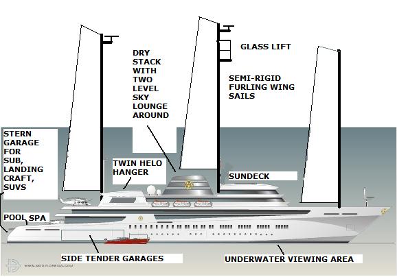

    Love your designs Lar. I have done a quick stretch mod to your Victoria 2 to create my fantasy yacht, please excuse the rehash :D I don't have a fancy paint program, but you get the idea.
  10. AMG
    5,392
    Thanks, yes I got the idea!

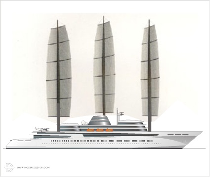

    I was thinking of something similar already when I first made this design and at the same time got to see the first rendering of Maltese Falcon. This was the result... ;)

    Hmm, reminds me of a song, "there's a mast in your funnel dear Lars dear Lars, there's a mast in your funnel dear Lars a mast. Well shift it dear..." couldn't help myself :p
    Thought of the dynarig but wasn't sure of the esthetics, it seems more suited to yachts with a low narrow hull and low superstructure, and with turn of the century classics, hmm 4 on the Saravona would be magic. A normal rig has to many stays etc for a large motor sailor M/Y and is too ineffecient, though I see you can with new materials do away with stays etc, I guess at the moment a wingsail is going to be permanently set, unless you go with a kite. Hmm. With the price of fuel so high, I guess a private nuclear M/Y is out of the question.
    Drifting a bit off topic so time to brain storm in my own time hehe.
    Cheers Lars.

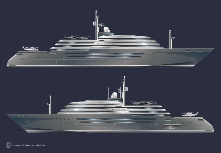

    Pandora Xxl
    At 600 feet, the latest and largest Pandora is a true Gigayacht, or XXL... :)

    What would the beam be on the XXL version?
    Just playing with a quick thought on the total sqare footage of space :)
  14. AMG
    5,392
    As I always try to maintain the same beam as height, she will be 92 feet wide. Maximum draught 20 feet.

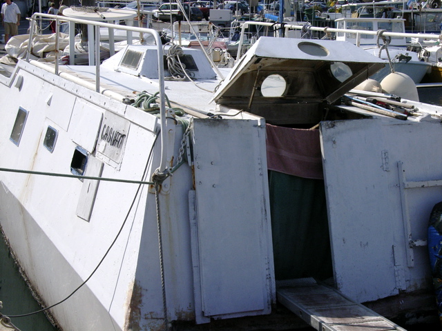

    So about the volume I will chime in with the little floating home at the wall in Port Vauban, Antibes. It has a sign saying "Ca suffit", teasing all owners and crew while they are going to their Megayachts at IYCA...:D

    Wondering where you'd place lifeboats, probably required, on Pandora without destroying the lines?
  19. AMG
    5,392
    Hi Codger,
    Same as on the smaller Pandoras, the stern is open with a pocket for lifeboats. Not that you need to have them if it was a private yacht I think, but still there is space for two 80 pax boats there. Life rafts are stored on racks in front of the aft helipad and are released through the big openings there.
