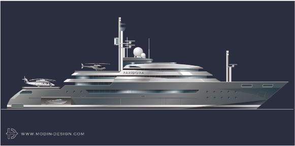

    It is now 2006 and about time to start a new design thread. I hope to make at least some new yacht concepts during this year.
    My first attempt is not entirely new and is developed since the sales of the 170 m Pandora design has been pretty weak...
    So here is a 122 m version, 400 feet, with two decks less than the original design from 2004. Still with most of the features from her bigger sister.

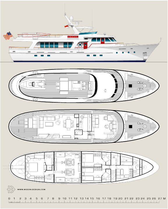

    And finally, for my personal use, I would stick to the little 26 m classic below, just because she has everything I could ask for and I can manage her myself.
    So Codger, which one would you like to have? :)

    Your little 26m has a gracious strength. What kind of a range on full tanks would you expect? Could be fun sitting on the flybridge dodging ice off the coast of Greenland in the spring.

    The 26 m has a range of 3.500 nm at 8 knots and I think 4.000 at 7 knots. Normal cruising speed is about 9 knots with a range of 2.700 nm, so she will take you to almost wherever you like. Especially if you use Dock Express for the long crossings...

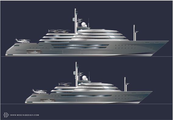

    170 m + 122 m Pandora
    Some of you have asked for a picture comparing the two Pandora´s, and since they look alike I can understand this. So here they are again, side by side...

    I quite like Pandora (especialy in large), she is one of my favorites of your designs, but to me she has just a few to many angular type lines, with the lines finishing the two long windows in the hull pushing the theme just over the edge, In My Opinion.
    Unfortunatly I can't offer any solutions. Except that I wonder if she would look better with a row of large portholes, perhaps even capsule shaped portholes, but running horozontaly?
    Shame, I like large windows.
    After another look, perhaps if the five main angular lines were softened a little they may flow a bit better?
    Sort of like Y702, a little bit of curve taking the edge off some of the sharp lines, adding a smidgen more sleekness as you go.

    The big windows in the hull are also balconies to the guest suites, why portholes can not really replace them. Eventhough oversized "portholes" including a balcony would be a great idea!?
    On your thought on softening the lines. I think each design has it´s merits and I think Y701 looks twice as good as Y702. One of the few large yachts with soft lines that look OK is Pelorus, although she is a little too big for that kind of costume I think...;)

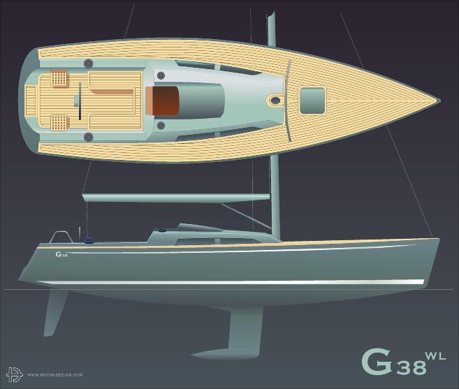

    Club Racing?
    This 38-footer is from last year but today she got a new and more sporty deck and superstructure. In this version she will be a nice day-sailer with a self-tacking jib, but also possible to use for a yacht club as a one-design racer in a sensible size.

    While I like the look of the Pandora's, I found the freeboard on both to be huge. Over 40' on the 122m one, and over 52' on the 170m one.
    The total height from the waterline to the top of the mast is 161'.
    A Nimitz class supercarrier has a height from keel to mast of 244', with a draft of 38'.
    Your yacht is nearly as imposing, dockside, as a supercarrier!

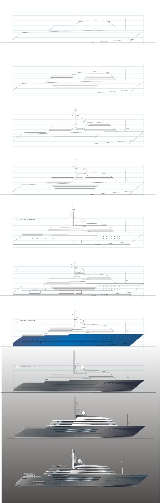

  15. AMG
    5,380
    You are right, she is high. But also beamy and to let the light in towards the centre of the yacht, the ceilings have to be higher than on a smaller yacht.
    I made a grid with 3m (10 feet) for each floor which is pretty normal for a yacht this size. Here you have the entire history of the concept from the first line to the finished profile.
    As you can see, she was a little more aggressive from the beginning to finally grow from 165 m to 170 m, with the superstructure more centered over the hull. The resemblance with a war ship is of course to make her a little imposing. Maybe will keep pirates on a distance too? :cool:

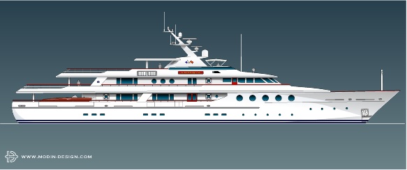

  19. AMG
    5,380

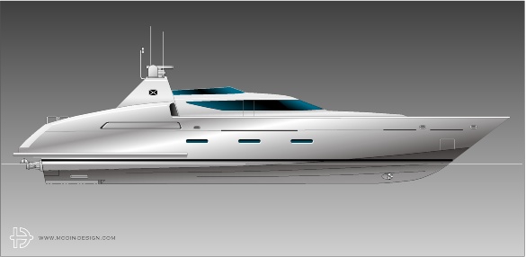

    Executive Waterjet...
    I have not posted many new designs here lately I am afraid, and this is a ten year old 110-footer that I have updated a little....
    Hope to be back with something newer next time..:)
  20. KCook
    KCook Senior Member
    Jun 24, 2005
    1,160
    Phoenix
    Really sweet Lars. Any chance of raising the radar arch a bit? Or is this an open deck that is occupied only at anchor (party on :D )?
    Kelly
