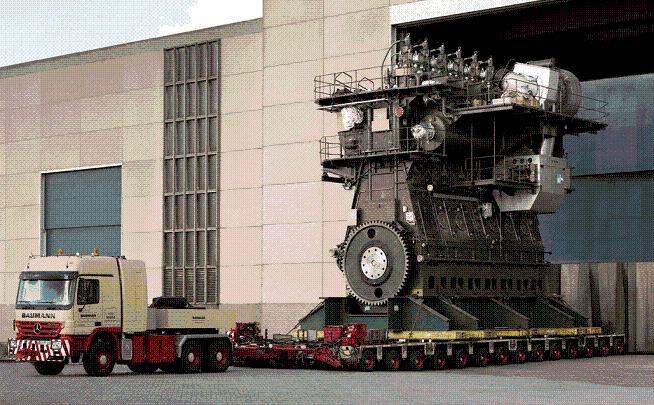

    That's not a BIG engine,....here is a BIG engine :D:eek:
    ....good story of big engines
    BIGGEST ENGINE
