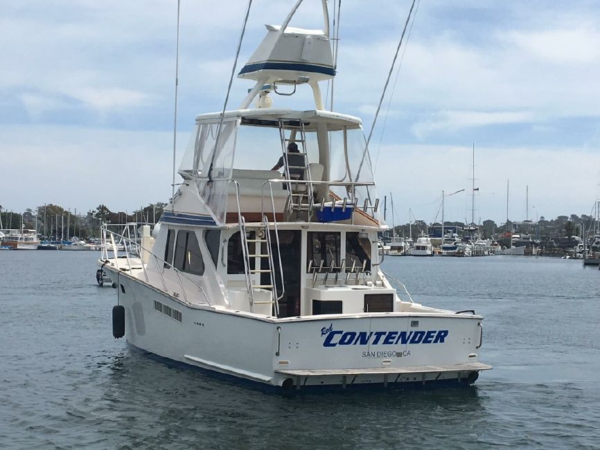

    Here’s an example of a proper designed ladder with handholds that allow you to hook your elbows while carrying a drink in your hand up to the Flybridge:
  18. Pascal
    8,730
    Nice one. The critical element of ladder safety are the grab rails extending way above the floor as mentioned earlier
