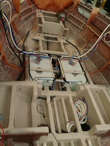

    During the 4 years I owned my L650FLY I was aware that water tanks had been an issue on some boats. I never had such issues.
    Adding bladders isn’t ideal, but seems to have been the path of least resistance. I’d imagine they would last well and be easily replaced if there were ever a problem.

  17. Capt Ralph
    13,848
    Alloy, roto plastic or glass tanks?
    I wonder what work was done on the tanks before adding a bladder? Cutting out the baffles?
    Or, the problem with the tank,,, No baffles and tank failures??

    The tanks are rotomolded and buried under the companionway and stateroom interior walls.
    Here is a photo of the tanks in place before the cabin sole was installed.
