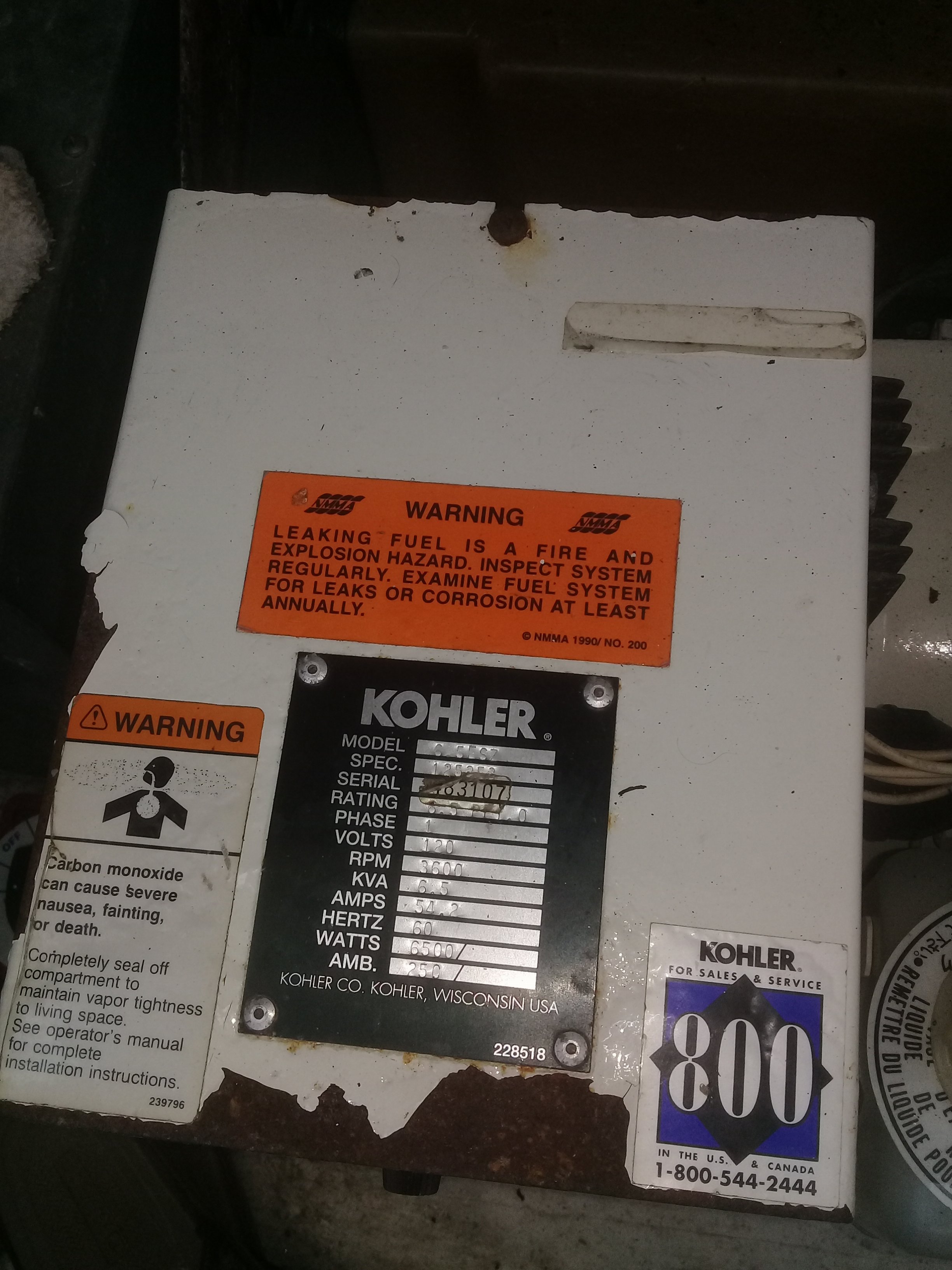

    20200806_164326.jpg Hi thanks for the comments,
    Model # 6.5ESZ
    S/N 483107
    SPEC 125253
    Oil seems to be coming from underneath the oil pump, near the engine/stator flange?
    Has anyone seen this before and is it an easy fix?
    Thanks in advance.
