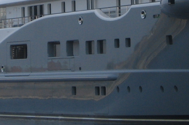

  3. K1W1
    7,453
    The poster probably wont admit that unless he offers a blatant plug of his own skills and worth to any project.
    The problems with the actual materials used are well known in the industry today.
    There would be very few mega yachts launched in the last 10 yrs where there was 100% satisfaction with the overall finish and appearance.
    There have been many DOI problems particularly on darker colours and white ones have not escaped as there have been problems where the finish looked great a few days after application but had yellowed and gone almost transparent in places by delivery a few months later.
    The problems are not all confined to the top coats the filler has also gone through several re mixes al of which seem to have their own share of issues.
    I know the vessel the photo above was of, there were patches onboard that looked a whole lot worse than what is shown in that photo.

  5. HTMO9
    HTMO9 Senior Member
    Jan 13, 2009
    1,681
    This yacht and her two sisters are definitely not among the best examples, this yard has delivered in the past. And this not only for the less than ideal appearance of of her / their hull(s).
    IMHO, their external and internal internal layout and even more their internal design were at least a little bit questionable.
    But as we all know, this yard can do far better and sometimes even industry leaders can be limited in performance, when forced by the customer (Due to timeframe, budget and most of all personal taste).
    And it should be noted, that in most northern European yards, the complete fairing and painting process of newbuilds is done by subcontractors, mostly by companies and their workforce from Southern Europe. Inhouse paintjobs or local subcontractors would be far to expensive and those companies would have a lot of trouble finding able specialists in the local area, willing to do this very hard and inconvenient work. I know of some larger yachts, were this part of the completion process was excluded from the contract and / or the warranty and concidered owner supplied item.
    I remember the good old days, when fairing material and paint was of great quality and long lasting but just a little bit more poisonous :rolleyes:.
    And I know from personal experience, a dark blue, high gloss, perfectly faired and painted hull on a larger (steel or alloy) yacht (with frames and stringers) is a very tough task for any yard with the present chemistry. Just by mentioning the wanted hull colour in the owner briefing, the frame distance was already reduced by the yard.
    But car and aircraft builders have the same problems with this water based stuff. By saving the enviroment and the health of our crews and workforce, our ships, boats, planes and cars wont last that long anymore.

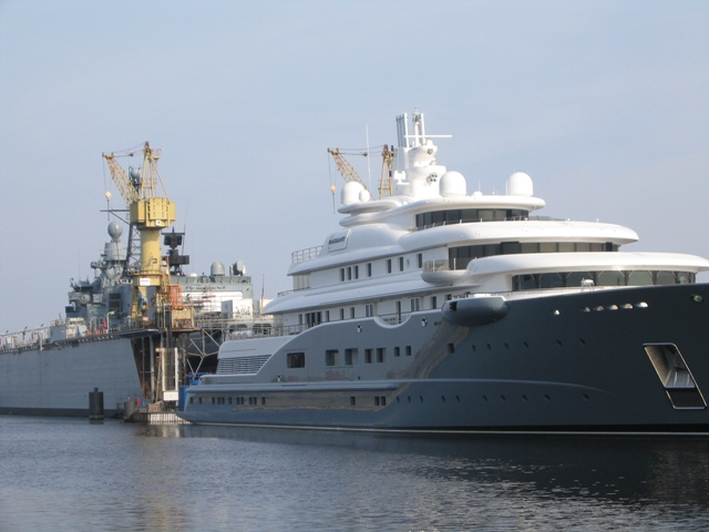

  7. HTMO9
    HTMO9 Senior Member
    Jan 13, 2009
    1,681
    Fairing and painting of such large surfaces with a long lasting high gloss effect is a really difficult task. Sunrays and the enviroment of southern lattitudes will make that job even more difficult. Those surfaces need a lot of permanent care.
    Achieving always perfect results is not easy, as one can see in these pictures, I took in 2010 at a yard in Northern Germany.

  9. K1W1
    7,453
    I would be interested to know who these wonderfully finished yachts are being turned out by.
