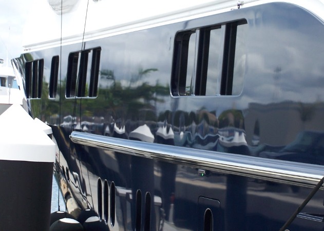

    Even when one of the industry leaders fairs and paints, the results are not always what you expect.
      74.1 KB
      2,100

    My comment was in ref to the blue topcoated surface picture, where we can identify some problems such as:framing effect( most probably construction problem -not enough internal framing maybe?, a non-acceptable fairing above the fender bar,( which could have been seen and fixed at least after showcoating)and not correct gloss appearance in overall! Problems that can be avoided if there is a mutual standard expectation set up in the project( applicator, Yard and paint consultant)
    Not enough reason to point only a Yard or applicator of not giving enough time and attention,it is a combination!There are big projects delivered on the very right quality ( much better than what we see in the picture) even if not very perfect. I know projects where there is good motivation from all involved parties , the expected standards clear from the very first date , strict controls during the process and final results really encouraging.
    We should not become boring here on the forums to readers ,by going so deep in technical language. Always welcomed to PM me..

    I think it is worth becoming "boring" because the photo is of a yacht taken very shortly after delivery from one of the most highly regarded yards in Europe.
    I have my own ideas about how that finish was allowed to see the light of day and few of them are related to paint chemistry or meteorology but my point is the best paint consultant in the world isn't going to the pyramid of issues which lead to what that photo illustrates.
    You wouldn't be a paint consultant by any chance?
