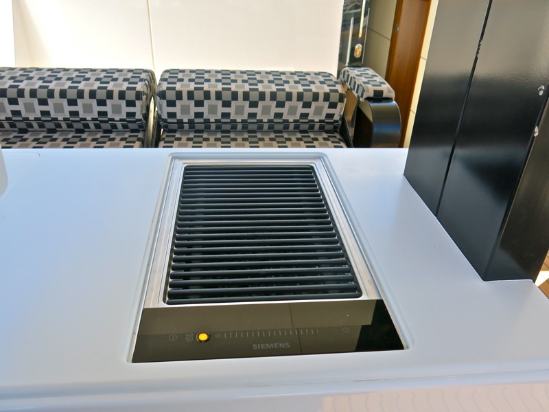

  7. AMG
    5,380
    We install one from Siemens in our boats...
