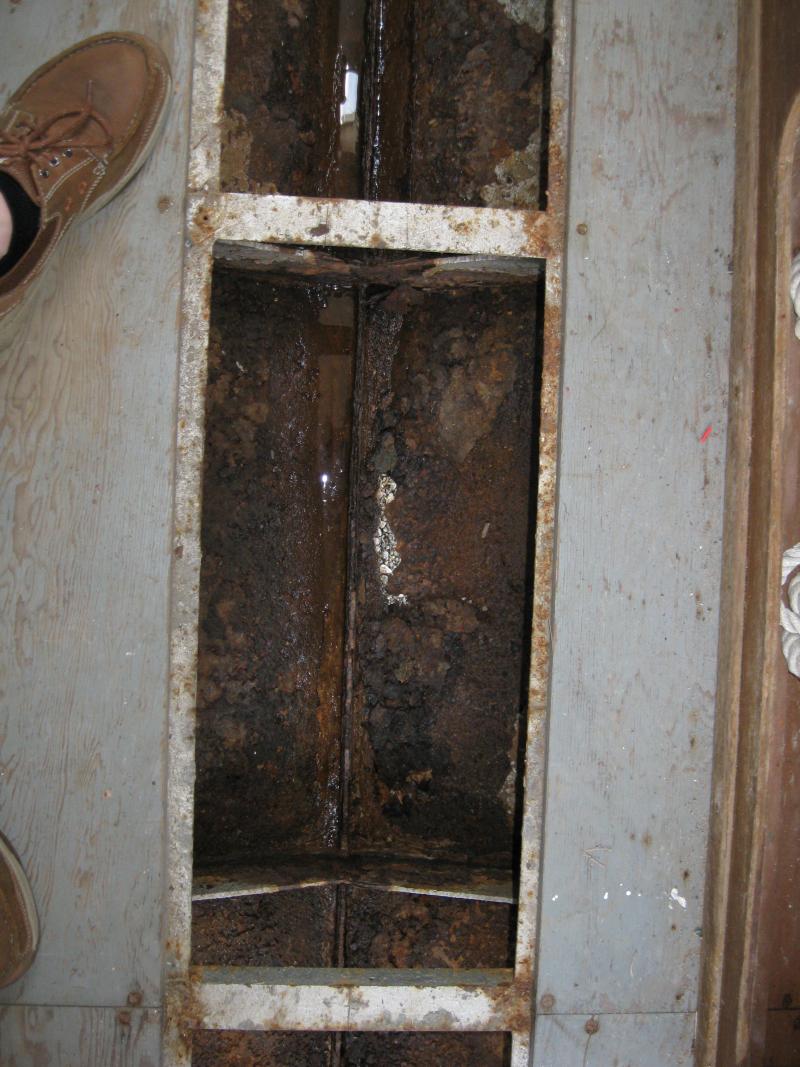

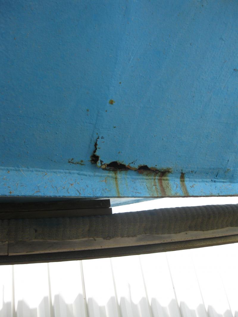

    Hi just brought this roamer and are wondering how much of a job this repair is , as the rust appears to be in the keel and seams not just panels , excuse me a bit of a novice to this , just trying to work out if I should haul home or sell again and call it a learning experience.I usually tend to prefer not to buy projects and pay more for someone else's hard work or pref mint original example , but this seamed so cheap to me so I took a punt , so if someone can give me an idea on the cost/job envolved from these photo's so I can work out if it was a great deal or if there is alway's a reason why something is so cheap , that would be appreciated .......Seller emailed me this info after auction Will take close up pictures tomorrow for you with a detailed write up of current condition. Basically, the engines still run great, all mechanicals are good, including lights, horn, all gauges etc. The hull up front rusted through at the keel, I will take close up pics for you. Was going to have front quarter from water line down replaced but have too many other toys plus another boat to play with & very little time. below is txt from when this boat was for sale on this site in 2007 which is when the person I brought it off purchased it , attatched are current photo's just taken.
    thanks in advance for any advice from past experience given. jason

    If its rotten like that all the way along you have a very big job on your hands if you want to do it properly.
    If you got it cheap enough try to move it on to someone who understands and can cope with what is required or hopefully you can look at it as a lesson learned.

    have asked how far along the keel does the rot go , just waiting reply , think the only rust through the hull of the boat is in the one place up the front as in the photo shown from what I can tell studying the rest of the photo's I received .
    paid $3500usd , but I live in New Zealand so the real cost will be in moving it , so just wondering if maybe a better example worth more needing less is more logical way to justify the cost of getting it here ( about 14,000 U.S from enquires ) door to door

    The rust is worse near the welds but you can't weld until you get to good metal. From the looks of it the bottom might need to be re-plated. The material is not that expensive but, you have to gut the interior to be able to weld the plate to the frames. Some of the frames will likely need to be replaced. Then you have to put it all back together. Personally I wouldn't spend the money to ship that boat to nz. I don't think the price was too high but, it's not worth much more than you paid. It doesn't look to me like it's had 20k spent on it, but I could be wrong.
