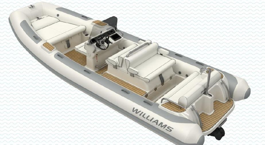

    Williams Jet Tenders are high quality production boats with a long option list and nicely designed.
    I have 3 Williams Diesel Jet Tenders on my present displacement boat. Two Dieseljet 625 as main tenders with stern launing in the aft lower deck space and one Williams 445 Dieseljet as SOLAS recue boat concealed on the foredeck with stored power davit launching system.
    - All tenders have Yanmar diesel engines and the tubes are made of neopren
    - They do not like to sit in the sun (wear and tear by sun rays and salty air)
    - We do not have anti fouling under water paint, therefore the tender will only hit the water, when needed
    - Engines and Jets have to be fresh water flushed after each use (by SOP and maintenance manual)
    - Pretty high useful load
    - Great performance under high power settings
    - The Yanmar inline engines will not last very long, when used constantly with high power settings
    (very high pleasure boat rating)
    - Pretty expensive boats with even more expensive spare parts (like most things from GB :cool:).
    - Definately no toy for kids to drive around with
    - the 625 are great for towing water skis and launching divers from
    - the 445 is in reality a little toy but it came equipped as a SOLAS rescue boat and was the only diesel jet fitting
    in the rather small tender bay in the bow area behind the crash bulkhead.
    Would I buy them again, Yes, without any doubt. Especially with the tender bays and the launching systems are being designed for and around them:).
