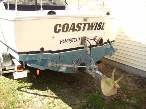

    As you can see from lower photo, the conversion has been done before to conventional craft.
