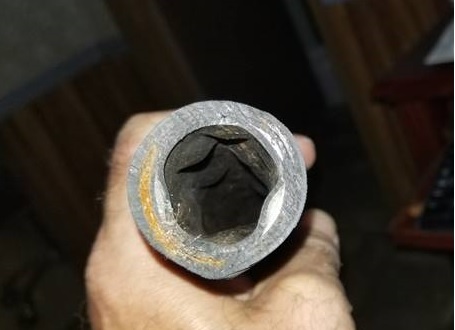

    I have been chasing intermittent hi pressure faults on our friends Hatt for a few months now.
    Half of the boats systems run from one pump, strainer, sea-cock, hoses and water manifolds, the other half on their own pump and stuff.
    Just the systems on the one set up has this problem.
    I would stay on the boat all day and it never would fault. The owner returns and one would fault within hours.
    I was starting to think he was possessed with an A/C curse.
    Thru the months of headache, rotated pumps, strainers and re-arranged a manifold.
    Every time thought I got it.
    Then one of the units would cycle and finally fault off line, hours later, with the owner onboard.
    Then I saw it, the water discharge fluttered for a second. Knowing it was not the pump, I cut a hose open.
    Hose Pox.
    The inside of the hose was de-laminating.
    All hoses replaced. Owner onboard 2 days now. All good.
    I have found this before on engine raw water supply hoses, I kicked my self for not thinking of this earlier.

    I've had a couple of fuel supply hoses do the same thing. The inner liner collapsed under vacuum and wouldn't allow fuel to flow.
