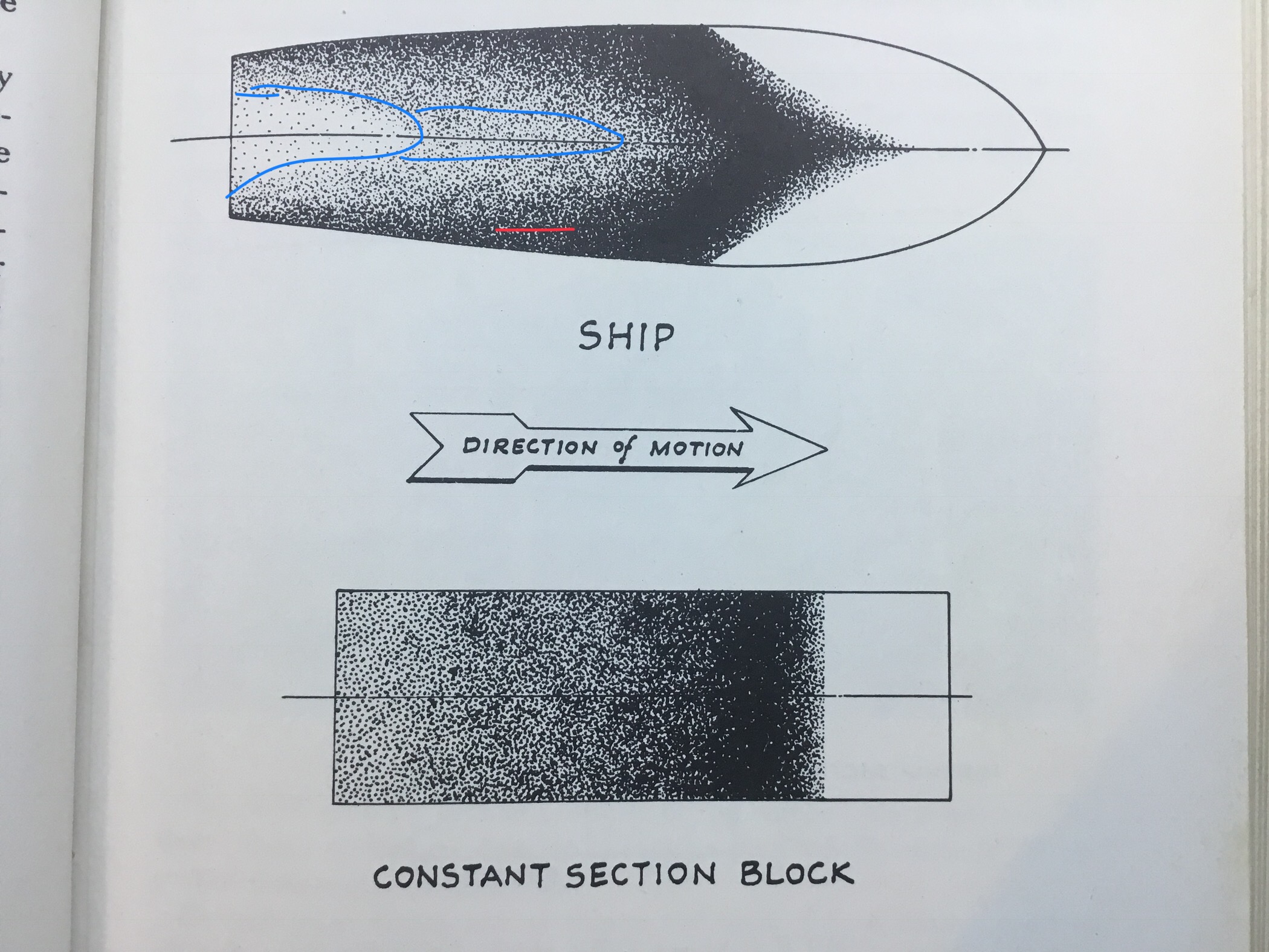

    Extracts from the book from pressure sensors in tank tests 1/8 th scale .
    Solid black is lift .50/50 dot density neutral see the red line .Excess white see the blue areas are suction , stern sinking .
    A vertical appendage efficiently ( interceptor ) decreases the size of the blue area I have marked esp the most rearwards .
    This is old hat tried and “ tested “ stuff preached in every university naval architecture course , in the tank .First year stuff .
    A prop tunnel increases suction in the already “ suction “ area .
