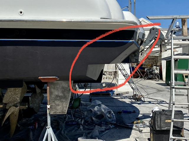

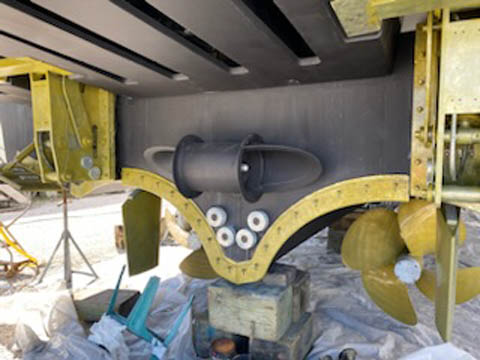

    I also wondering what this plate is for. It follows the tunnels all the way to around keel and sticks out about 3/4” below the hull
    the 84 Lazzara I used to run had a strip of stainless extending about 3/8 to 1/2” to provide lift replacing trim tabs. But this is not really providing any lift and seem to be adding massive drag. Plus the boat has trim tabs anyway.
    any idea what this is for?
    I love looking at boats in the yard
    20,379
    Band-aid for miscalculation on the original build, or to compensate for added weight at the stern following the addition/extension of a swim platform or to counteract interference, etc.

    Static interceptor to provide lift in the stern and unless its electrically or hydraulically articulating, you can't tell from the photo it would add variable trim.
  4. captholli
    captholli Senior Member
    Jan 4, 2010
    1,164
    In The Bilge
    I'm no hydrodynamicist by any means but it would make sense the more trailing edge wet surface area involved (i.e. keel) with the interceptor would provide more lift? Maybe our resident past life hydrodynamicist will chime in for input.

    The placement of these plates around the prop pockets would be an effective way to induce positive trim via thrust. It should be specifically useful coming on plane where traditional interceptors are not because they are typically mounted outboard of the thrust line, closer to the chines to control roll.

    It acts as a trim tab and does provide considerable lift, just like how Interceptor and QL and zipwake blade style trim tabs work. Think of flaps in an airplane. the piece bolted onto the stern is a fix for an engineering F' up.
  9. Pascal
    8,167
    Indeed for a strip on the edge of the transom to provide lift it would have to be close to horizontal like we had on the 84 with the strip where trim tabs would normally be.
    I can understand getting some lift from the sections near the top of tunnel but I can’t imagine the nearly vertical section on the side of the keel providing any lift. Only drag. Weird.

    I agree Pascal. The vertical sections appear to create more drag than lift, but it's the sum of the surface area that is contributing to an encapsulating effect. The vertical sections aren't just redirecting flow, they're diverting thrust which adds lift coming on plane.

    Those additions are made like 1 inch down the hull horizontal line, and I think they are made to keep the bow down. They look after market IMO.
    I have not seen any SL with them, though I have not seen many of the new ones.
    This Sanlorenzo looks an SL102A.
    There might have been somethings going on here, may be, and stabilization (most probably fins), which made the boat run bow high at a certain speed and captain decided to intervene.
    Remember when you have fin stabilizers open your trim tabs or blade style Interceptors become useless, and even closed they lose efficiency.

    If the permanent bolted on semi adjustable “interceptor “works then the answer should be a NO . Otherwise what’s it’s raison d etre ?
    Prop tunnels kill stern lift a major disadvantage, but countered by the lower shaft angles achieved a arguably better advantage in this case .Again erring on the side of rearwards machinery packaging gaining more interior volume .
    The time you are gonna need max stern lift is in transitioning, or turned around notice an issue , bit lacking ..of course just temporarily .
    On the plane all trimmed out running along due to the speed the whole hull of this length and weight will , or should I hope sit balanced pretty flat .That’s why I enquired about the transition phase .
    By not mentioning “ transitioning the stern sinking / bow rising” etc are you indirectly inferring the permanent interceptor illustrated in the pics ^^ are needed to get the thing to run level at planning speeds , ie without them it runs bow high ?
    I think they are there to increase the already refined transition to bring it up to a even better level ( scuse the pun ) …..in a complementary way exceed expectations.That’s why I asked / enquired .
    I just can’t see them ( San Lorenzo) cocking up the hull calcs like other posters , Unless JFM reports different?

    Could it be a band aid to help minimize bow rise while getting on plane? But then that’s what the trim tabs are there for anyway.
    Looking at both the SL and the Lazzara side by side shows a completely different designs for two boats which are similar in size. The Lazzara has prop tunnels and no trim tabs or anything along the transom. Yet, it gets on plane with minimal bow rise.
    if anything, the rear of the hull and transom, with a step and then an angled section seem to sacrifice quite a bit of lift. The down side of that is the prop wash starts going up further forward and hits the bottom of the platform which is why we had to add a second stage to raise it higher.

    That SL interceptor edge sticks down only around 3/4 inch so there is no way it is trying to make lift, in the same way a Humphree interceptor or classic trim tab does. It can only be to create a cleaner and more constant point where the laminar flow separation occurs, like a lip spoiler on the trunk lid of a fast saloon car (which is not there to create downforce and is only there to define and keep constant the point where laminar flow separates).
    This boat’s GA is a compromise like them all. Engine room is tight, to make big accommodation and an especially big garage. It’s just a choice/trade off that a customer must choose/make. I would buy the SL 106 instantly if it weren’t for the regulatory rules that I’d then have to endure. Compromises compromises!
