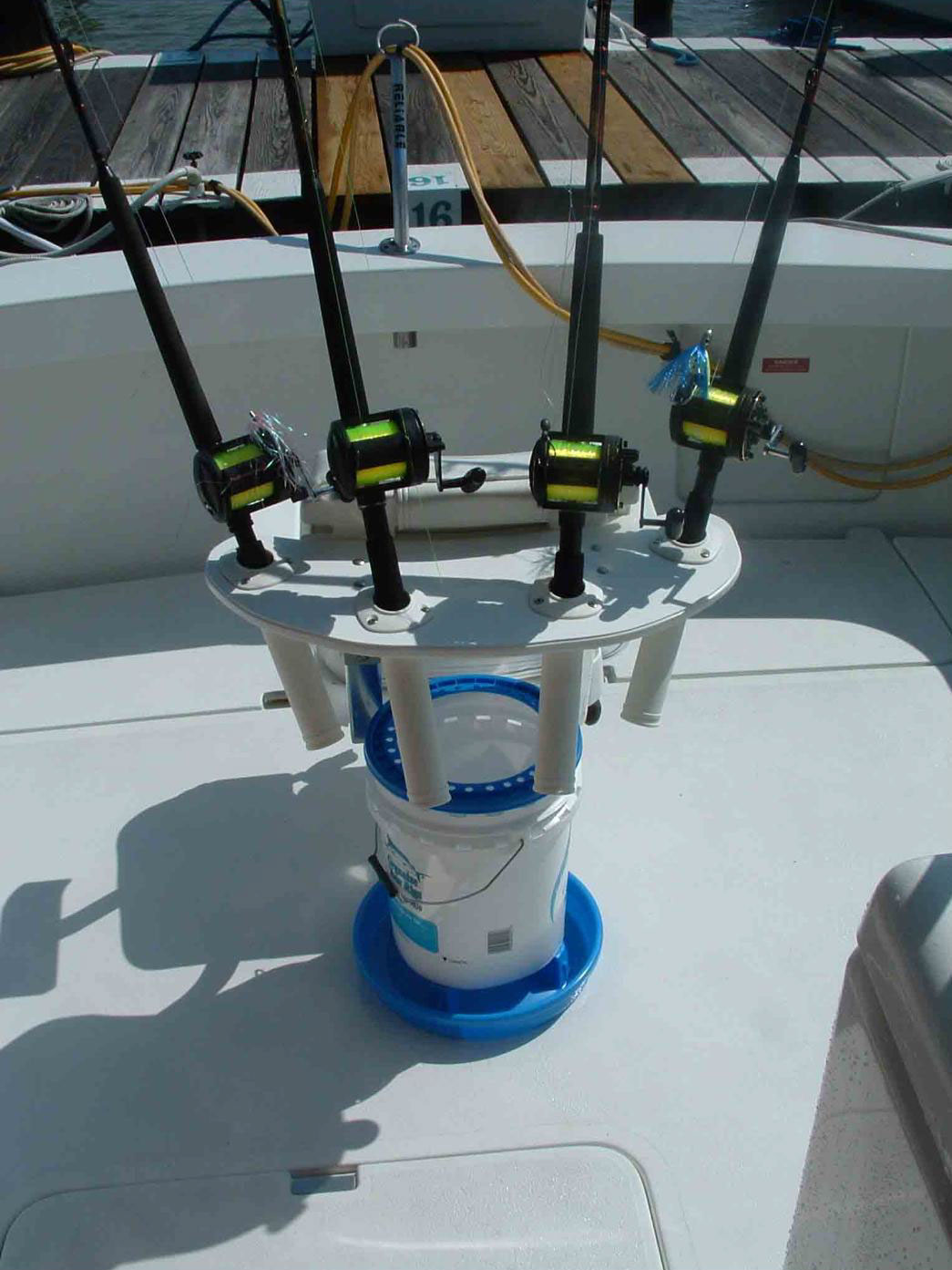

    I am going to be installing a pedestal based rocket launcher in the cockpit of my ‘04 38 Convertable. Does anyone have any experience doing this or installing a fighting chair?
    Looking at the cockpit floor, there appears to be a reinforced area in the center for this. I am reading some manufactures put a backing plate within the floor. I don’t see this, it just looks like thickened fiberglass.
    I plan on using a threaded backing plate, although there is only a few inches above the fuel tank. Working from the lazarette and side fish boxes to get to this area is a couple of feet. May be challenging. If not doable, my fall back is to install an inspection plate closer to the base of the pedestal.
    Any tips or advice appreciated.
    Thanks!

    Yes there was a backing plate, my first experience with “tapping”. Went great! Please excuse the dirty boat, still pretty cold up here on Long Island

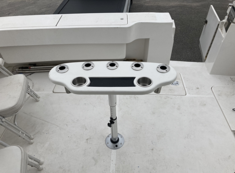

    Looks good! I want to install the same one on my 2002 290 Open. Where did you get it? Does any know if the 2002 290 Open has a reinforcing plate in the floor also?

    Call Tim and Kathy at (772) 208-7862, a Mom and Pop operation in Florida, “rocketlaunchers@mail.com”. Tim designed exactly what I wanted for a price comparable to premade ones. I am very happy with the quality. Robert Page, if you can see under the cockpit floor, where the plate is, the floor is noticeably thicker.
