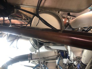

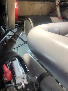

    I’m installing Air Seps in my 1988 46’ Post. The fuel fill line need to be re-routed a bit for clearance for the air sep...and yea it’s tight on other side..but works.
    my thought is to cut the copper, add a piece of Trident Fuel Fill Hose to bridge the few 4-6 inches I need to reroute, double clamp, tie wrap as necessary and be done.
    I would consider having someone come and braise in a piece of copper and two sleeves, but in review it appears the outcome isn’t much different and the safety factor ends up the same as the copper now has fuel hose sleeves on both ends.
    any thoughts or things I’m missing?

    Here are some photos- hose is the simple solution

    on my 1975, when the tanks were replaced, we used all hose from the fill to the tanks.
