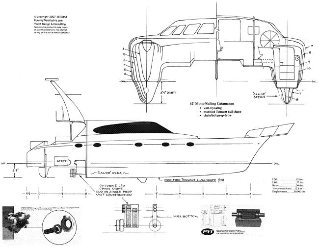

  6. brian eiland
    brian eiland Senior Member
    Jul 28, 2004
    2,979
    St Augustine, Fl and Thailand
    What if this drive-leg were turned around such that the props (or single prop) became pulling props as with IPS? And what if this drive-leg housing was incorporated into being the leading edge of the skeg-mounted rudder??
    You end up with a truly horizontal prop that doesn't pull your boat's stern under upon hard backing, less drag than a traditional prop shaft and strut, and a big variety of engine placements.
    Forgo the extra rotation capabilities of the IPS...and the big extra expense....and control the maneuvering just as you would any twin propped vessel.
    (A similar idea is under consideration for a gentleman looking for a fishing charter 55 motorsailer for SE Asia)
  7. NoRudder
    NoRudder New Member
    Jul 15, 2008
    34
    Virginia
    You may want to use some caution here, as the patent held by Volvo Penta has extensive verbage about forward facing props being used.
    I'm no lawyer, so it may not exclude your plan. Just FYI.
