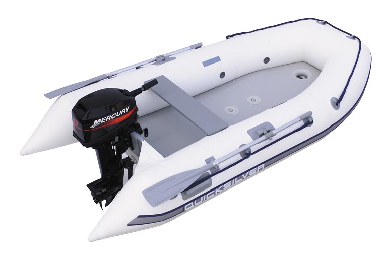

    We used to keep a Quicksilver AirDeck 310 aboard the 42' for the rare times it was needed. It had a decent V at the bow and the inflatable floor is easier rather than bits of plywood. Hyperlon is more expensive than PVC but better for wear resistance and UV, which is not really your concern here.

    We have a 9 foot inflatable with the inflatable floor similar to that which Fishtigua has posted.
    We use it the way you have described.
    Brigg is the brand I chose. It has an inflatable keel also.
    It weighs 80 Lbs which is pretty easy to lift for me.

    Thanks to all for the helpful information. Looking like a air floor would be best for my needs.
