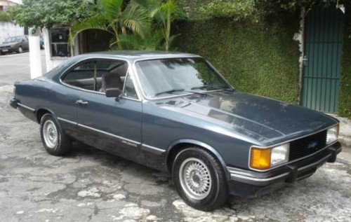

  14. Fishtigua
    Fishtigua Senior Member
    Jul 20, 2007
    2,934
    Guernsey/Antigua
    I had an old Chevy Diplomata, built in Brazil with the 4.1ltr straight six from the mid 70's. It put out 125hp and 200ft-lb on an autobox. The EPA fuel figures said it should give 18mpg but running in Antigua, often on dirt roads, at 30 to 40mph on low octane fuel, I got much better economy than stated.
    Those long stroke motors just purred along, burning very little at low revs. It was only when you floored the throttle did the fuel needle move toward the E mark.
  15. Grecko
    Grecko New Member
    Jun 27, 2009
    50
    Presently landlocked
    The basic Chevy "Stove Bolt" six traces it's lineage back to the late 20's. The 4.1 was designed in 1962. Good engine, but only 125 hp from 4.1 liters is pretty low specific output. A BMW 4 cyl of the same vintage could make the same power, but wouldn't be nearly as nice since it wouldn't have the torque of the bigger 6. This engine had 7 main bearings. Good for reliability, but that makes for a lot more bearing drag than a v6 with only 4 main bearings. This is another reason for the switch to V6's, when the EPA mileage is on the window sticker, the better number you can post often swings the sale. Also with CAFE standards, it helps the manufacturer to reduce the fuel consumption of any and all of his cars. While I'm sure a V6 is more expensive to produce than a straight six, they want the lighter, smaller, and more efficient engine in a car.
