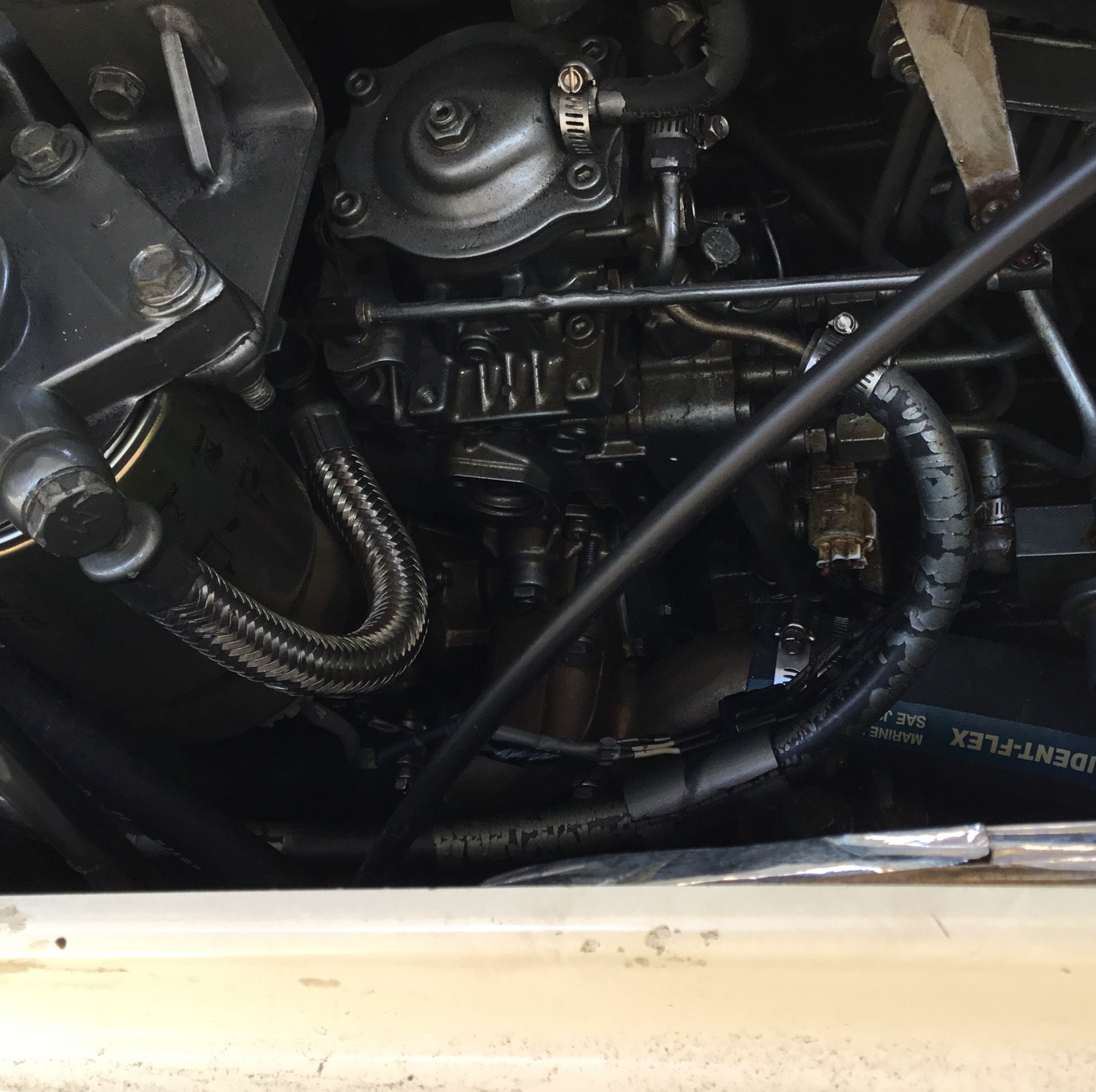

    Think that was the plan. reach in, loosen the wing nuts (not remove) slide cover off the pump, switch impellers, slide cover back on and tighten wing nuts.
    If O rings are properly greased; they should stay in place.

    Ouch, I remember this model. Strange looking water pump. Yep, below the governor. You can follow the water hose to it.

    Shoehorned in.
    Not enough space to slide the impeller out, the entire water pump has to be removed.

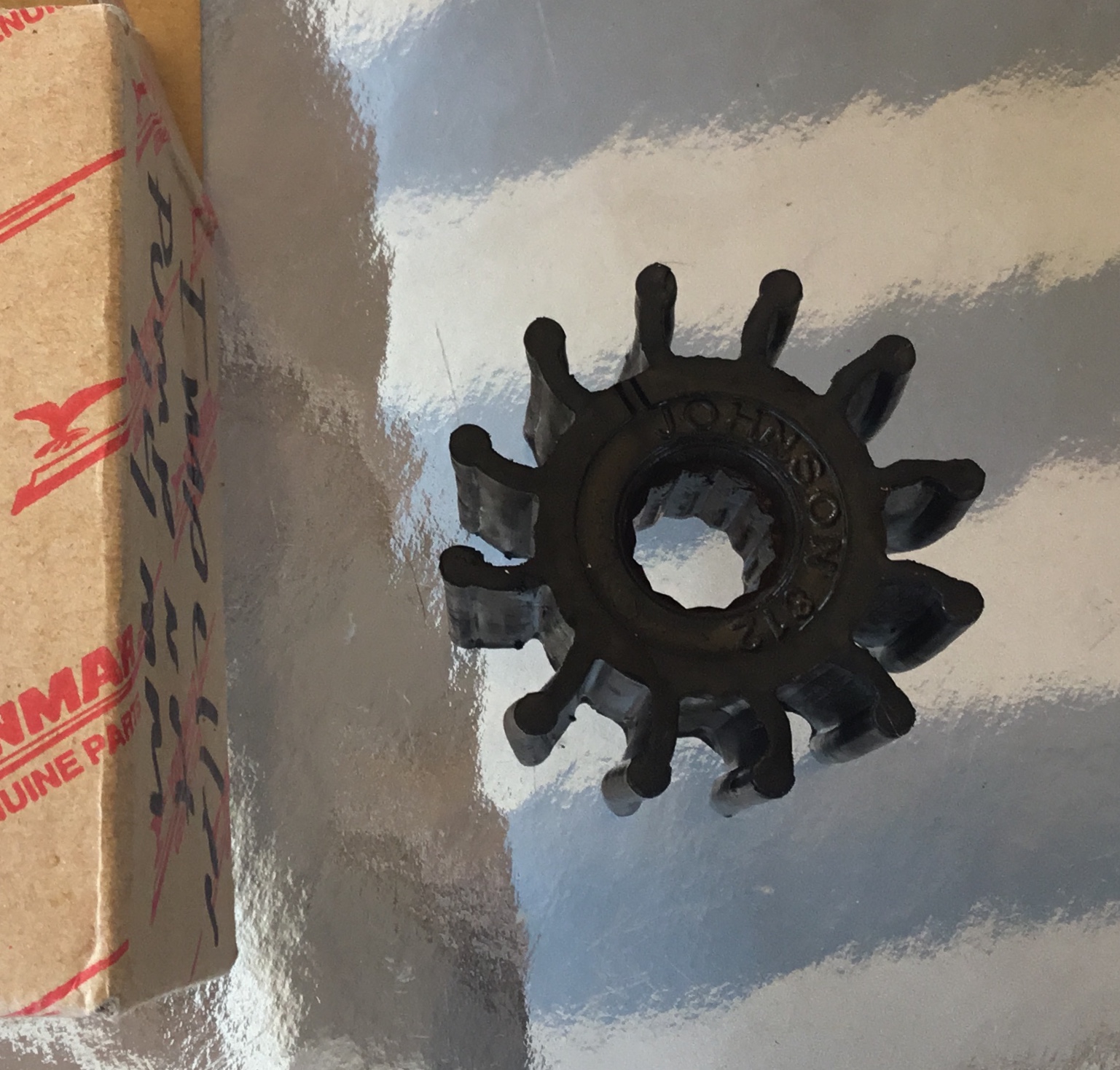

    Indeed, it
    The set is not always a big problem since centrifugal force helps spread the blades a bit
    looks like a spring start up rip, or a solid. That's why I asked if there are racors or a basket on the intakes

    Good clear Perko strainer. Hose new with gen set. About two years old. Previous impellers on this set went to pieces early also.
    1) Its a long 3/4" run. Maybe increasing hose size could help. Plentey of water coming out.
    2) Or picking up air near a strake.
    I'll be back on board this fall to look these ideas over.
