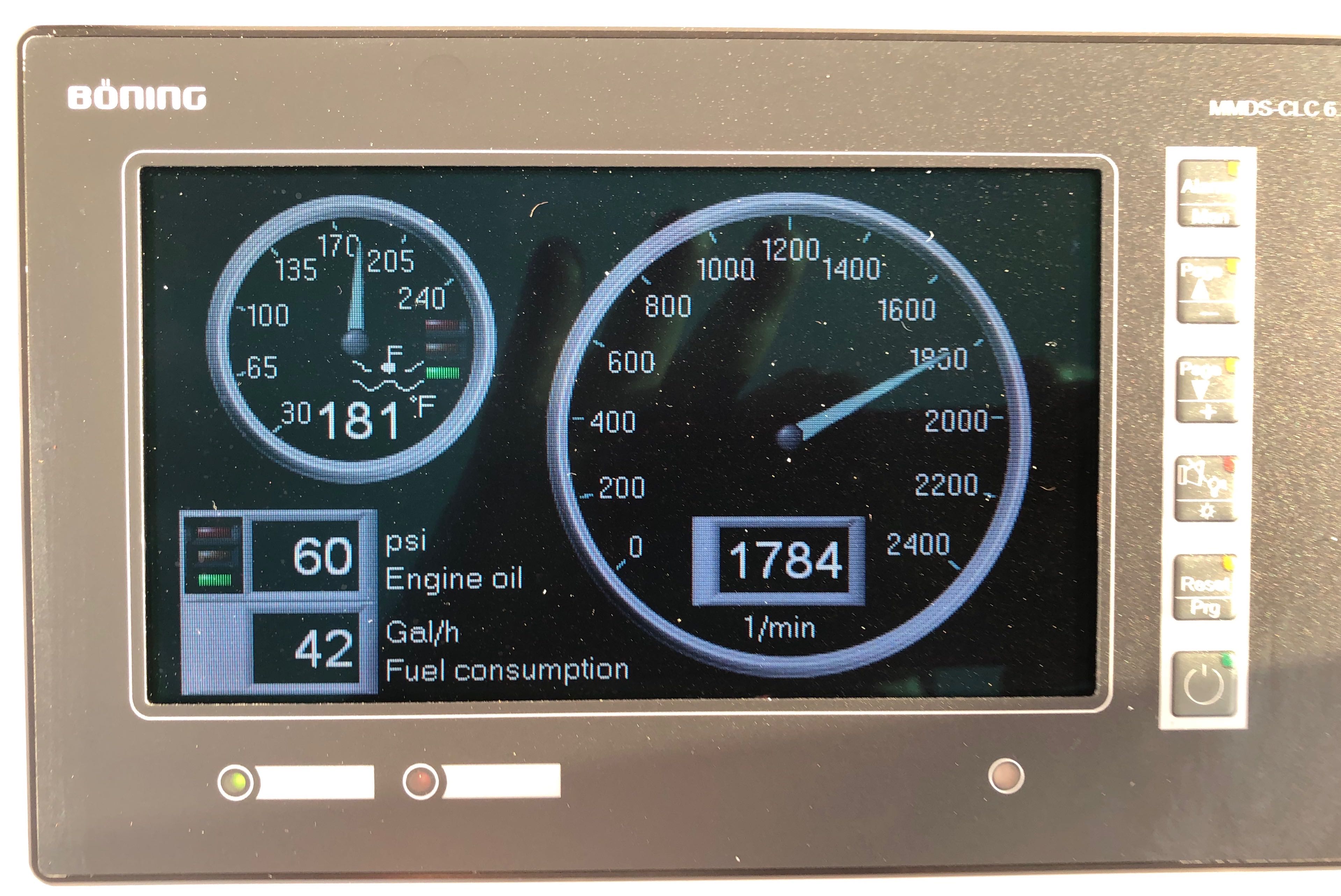

    I did my Spring sea trial to check the numbers and get the baselines. The mains with the new impellers were 2° cooler with similar water and air temps. IMG_0755.jpg
