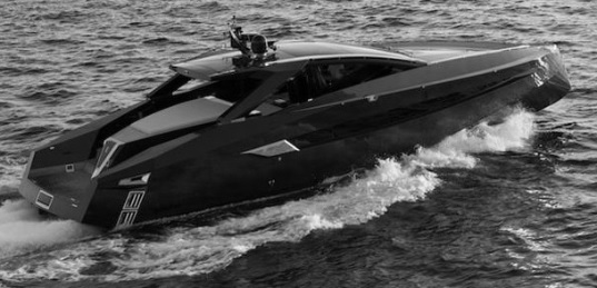

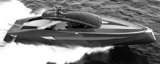

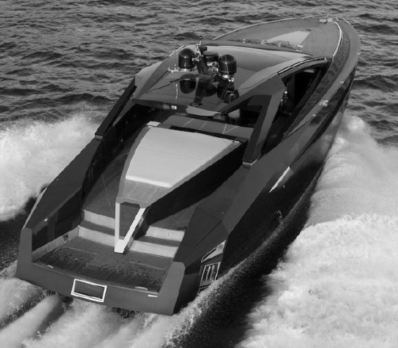

    Let’s envision building a 19m-20m (+/- 64ft) yacht. Modern, stylish and appealing to the eye; maybe something like the Art of Kinetic of 6 or 7 years ago… or maybe, simply re-engineering this one.
    What would our priorities be?

    What makes a good boat? I think that has been answered in this forum in the past: “Tough, good in rough weather, easy to handle and simple to keep running.”
    So… how would you incorporate these qualities into this vessel: if you were starting over?

    The first thing I see in the photo is not using the salon/cockpit space for seating as far back as possible. I also don't personally like not having a full transom.

    after looking a the pictures..........how does one get paid to design a boat so impractical ?????

    To me, Claymore looks like a boat, whereas the first pictures in this thread look to me like someone just designed something swoopy that happens to float.

    Ditto on the responses so far. Cooling off this heated debate, I would place simplicity high on the list; a more analogue boat. Would it look anything like the tactical assault platform in the OP’s pics? I’m affrayed knot. ;)
