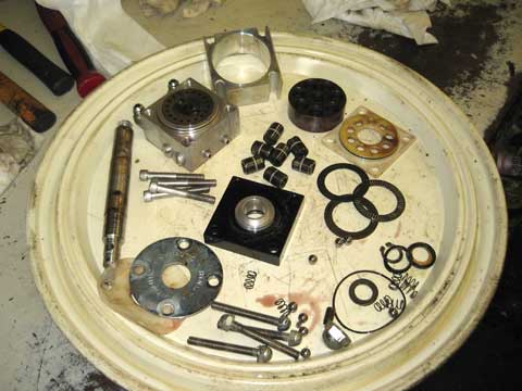

    Found a small fluid leak so time to get the steering unit rebuilt. Anyone used Southern Charm or recommend another ??

    If it is a pump leak, it is usually the front seal that leaks, right behind the wheel on the shaft leaking that requires a re-seal.
    A couple of O rings and that front seal is all that comes in the seal kit.
    Many times our customers had stated exactly what you typed above,, if not the front seal,, we find something is just loose behind the dash on the pump, not in the pump.

    I'm sure it's a pump leak. After letting out all the air pressure it eventually stopped dripping. Color code marked the hoses but ran out of daylight so not yet removed the 3 of them, nor did I see the model number on the square pump.
    The photo Southern Charm posted was probably as they planned, intimidating, so filled out all the info for service but not yet heard back. Might be simple O-ring but some things probably best left for the pro's.
