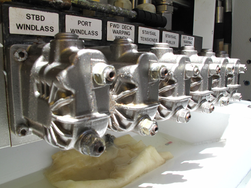

    Just looking for some thoughts, I have Maxwell 6000 Vertical Windlasses onboard(Hydraulic) I have been told by deck crew that they are running sluggish/slow.
    Does anyone have any experience in these kind of matters. There is a control valve block which controls the hydraulic oil to the winch, could there be something wrong inside there to effect the normal operation of the windlass?
    Any other ideas???
    Ive attached some pics
    Thanks
  2. AMG
    5,375
    I have not seen the same valves as yours, but normally they can be adjusted manually to get a desired function/speed on the different things connected to the hydraulic system.

    Yeh that tool is used on there, I have not done anything yet.

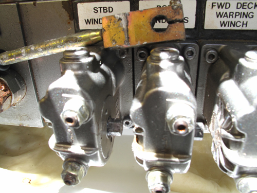

    The Hyd Motor that servers that Winch might be worn or damaged, the Solenoid Valve (I am guessing that you have Electro Hydraulic controls) that serves it could also not be opening properly.
    How is it when you crank the valves in the photo open manually?

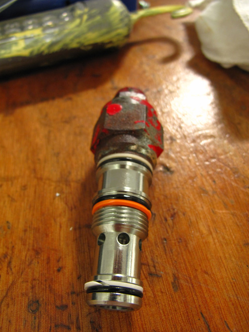

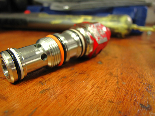

    Okay thought I would give some feedback, underneath the Windlass is another valve block, I removed two valves and inspected the seals/o-rings and it seems that the orange one as in picture is slightly damaged so not sealing correctly and thus the valve is not functioning as it should.
    Getting spares and will reinstall the valves and test out the Windlass.
    See pics.....

    That does not look like much damage to stop the winch motor from turning without a load on it. If changing the O-ring has no effect maybe the motor is a different displacement than the others. It may have been resized to give more power or mistakenly replaced with an inexact match.
