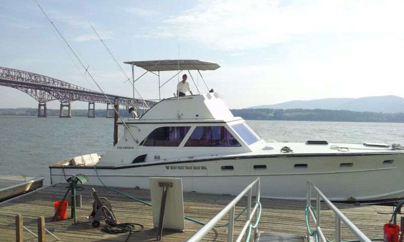

    My 43' Egg, "Three Belles" before and after Sandy in Jamaica Bay NY, it was my home too

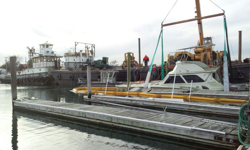

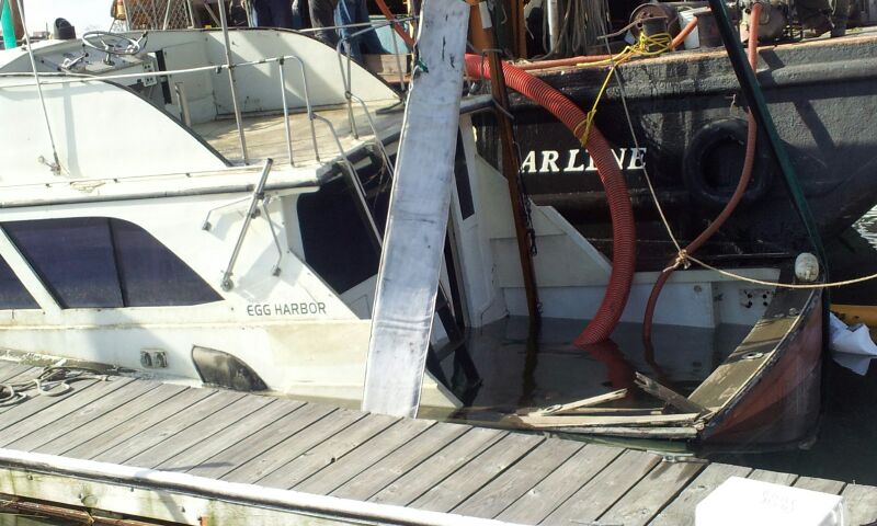

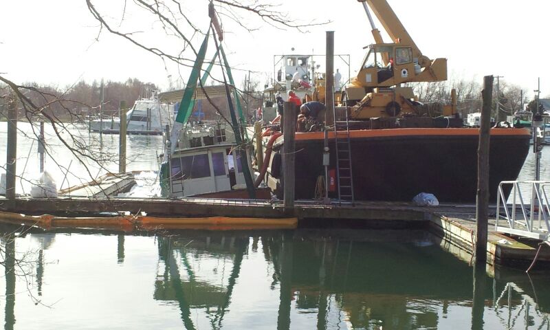

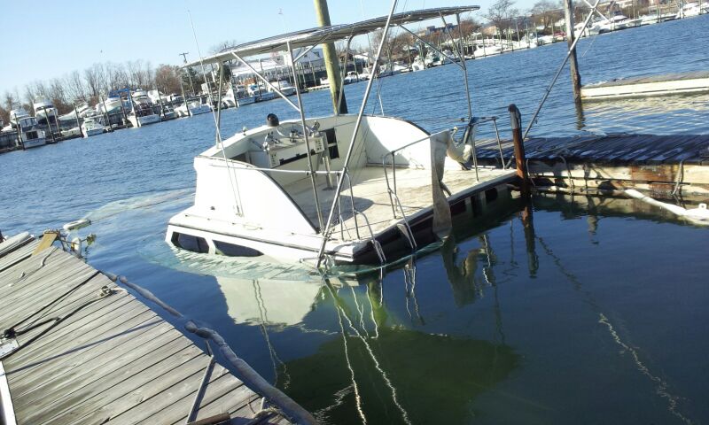

    Guys, Firstly I cant begin to tell u how much your prayers and feedback has helped me in this time, and Im 110% thankful and grateful to all of you who have been there for me. If ever ther is a time where I can do for you, please, please, let me know! Seriously. The banter, the support, the prayers have literally paved the way for me to hold my head up. Thanks to all of you, you know who you are. Secondly I want to post you on the progress of the Mission,, Raising the " Three Belles". I was with the Coast Guard all Day today with one of the bigest outfits hired by the CG around here to do the job. WELL, with a 90' barge, tug boat to hold and navigate, and a major crane, they were unable to raise to the point where she could hold. What they found was, I major breach in the hull approx 40- 80 square feet of breached Hull. as a result it will stay in Its in the slings for the night untill morn and we can come up with a plan B. It will probably go back down over night but the fuel has been pumped out and as a conservation point of view she is safe for now. We are not sure how to get her on the hard. There is a very long reach to get clear and through whatever obstacles to land her so we are looking into all alternatives. I will try to post pic's. Again, Thank you all !!!
      86.5 KB
      1,133
      75.5 KB
      1,056
      70.6 KB
      1,118
      81.3 KB
      1,108

    Did they consider using inflatable bladders to float it up and hold it in position? Maybe then a diver could have gone under and screwed in plywood over the hole to stem the leak. Sorry for your problem.
  18. SHAZAM
    SHAZAM Senior Member
    Jan 26, 2008
    601
    The Ghetto
    Tom, airbags are rare enough as it is, I can only imagine how rare and sought after they must be after this storm. As you can see in the photos the salvage equipment that they're using isn't really the ideal set up, barge that looks like it may be a tank barge, smallish rough terrain crane, etc. Sort of makeshift when compared to some of the rigs we've seen down here in Florida.
    My best to Garrbo and his old Egg, hopefully she'll be salvageable. As far as the motors are concerned, make sure you pull the injectors and fill up the cylinders with oil/diesel or whatever and try your best to get all the water out of the motor. Also, don't forget to get as much lubricant through the blower as well and try your best to get all the saltwater out of the bellhousing.

    Shazam, I guess I'm spoiled by watching TowBoatUS use bags to raise yachts down here. Hope it works out for Gar.
