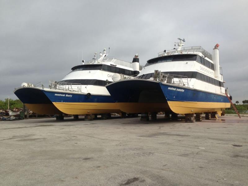

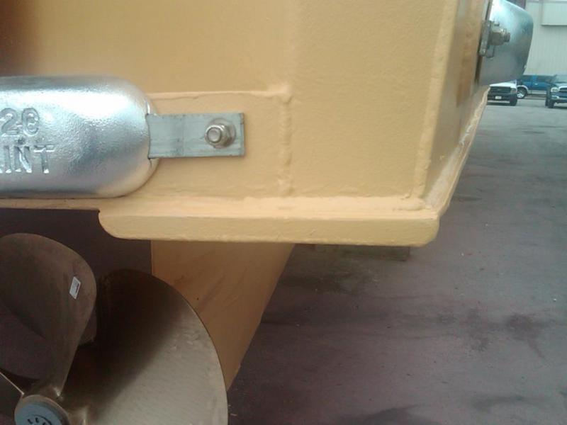

    These boats did 29 knots with 2 x 1760 hp when new with a full load of passengers. With an engine down they would only do 11 knots. After they where fit with simple fixed interceptors they did 20 -21 knots on one engine. A picture of the interceptor to follow.

    Fixed Interceptor

    The effect was amazing. Lobster boats used to do it by running a deck line under the boat between stern bits and pulling it tight with a come along.
