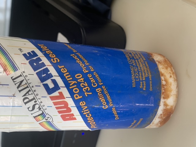

    They advertise it as a sealer. I just finished sealing the transom on my Awlgrip painted boat. 1E1C054C-E255-41B4-BAFB-E52F4EABAF85.jpeg

    It's a sealer. I've also found that it kind of works like hand moisturizer and puts back into the paint. Here's from the Awlgrip website:
    Awlcare is a protective polymer sealer, formulated to protect Awlgrip, Awlcraft 2000 and Awlgrip HDT from acid rain, environmental pollutants and abrasion. Leaves a non-yellowing protective coat that lasts through multiple washings."

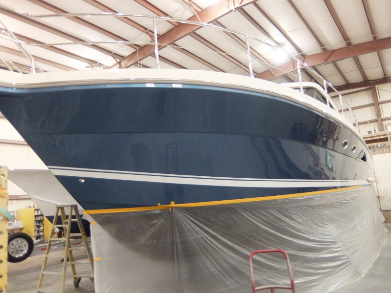

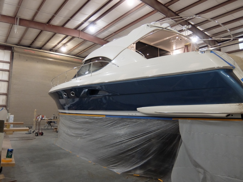

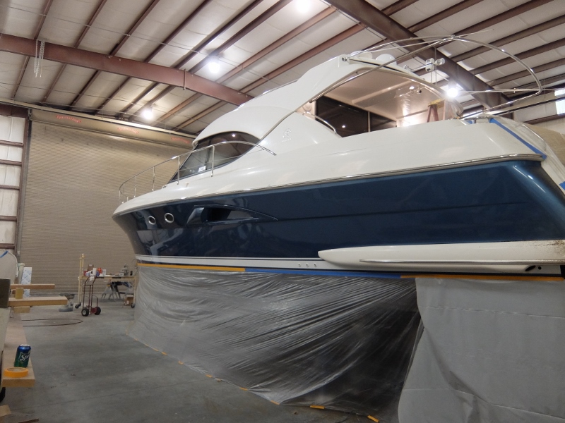

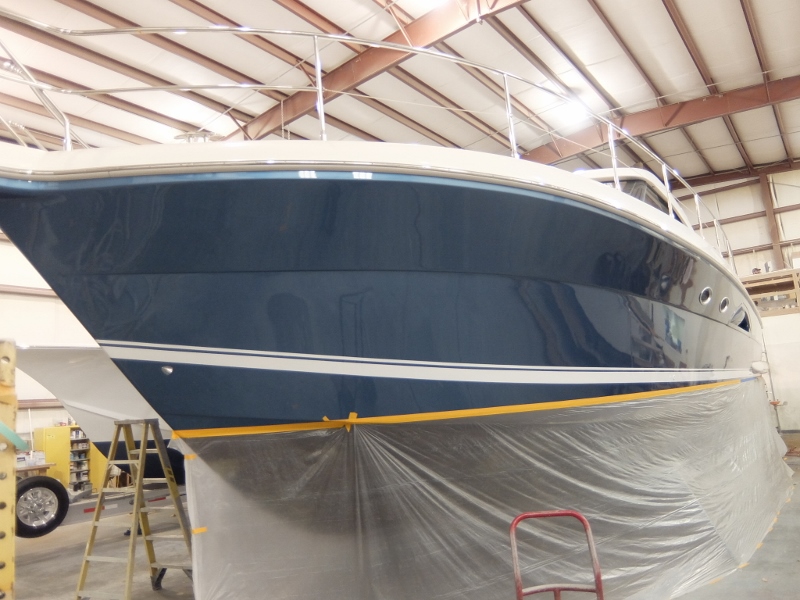

    One other possible option you have, and one I really like doing, is to put a clear coat over the final color shoot. This helps in a couple ways, one is you have an extra layer on the outside that may be easier to blend in a repair on and two, the Alexseal clear base is much thinner than the pigmented base colors and much easier to nail with minimal orange peel. With the increasingly popular base coat/clear coat metallics it's a mandatory step anyway. In fact, it's been years since I did a hull with a solid pigmented color, they've all been metallic lately! I always add the second batch of clear coat passes just to get a thicker "candy shell" over the metallics too. These pics are right after the second clear shot on fellow Yacht Forum member Mark Woglum's Riviera, Palma Blue Metallic.
