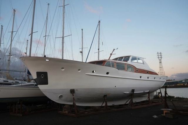

    Front view
    Front view of TIKY on hard after painting

    What an elegant boat.

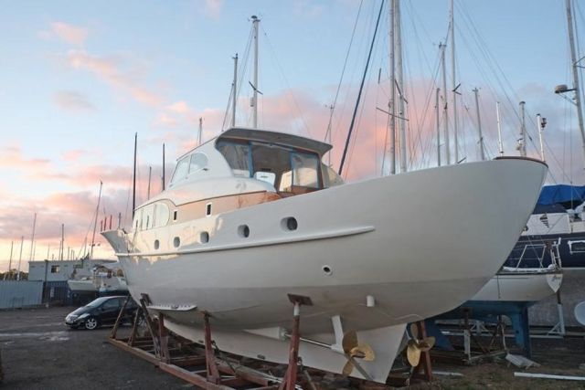

    1962 62ft Feadship TIKY paint
    Thank you. Here is an another view

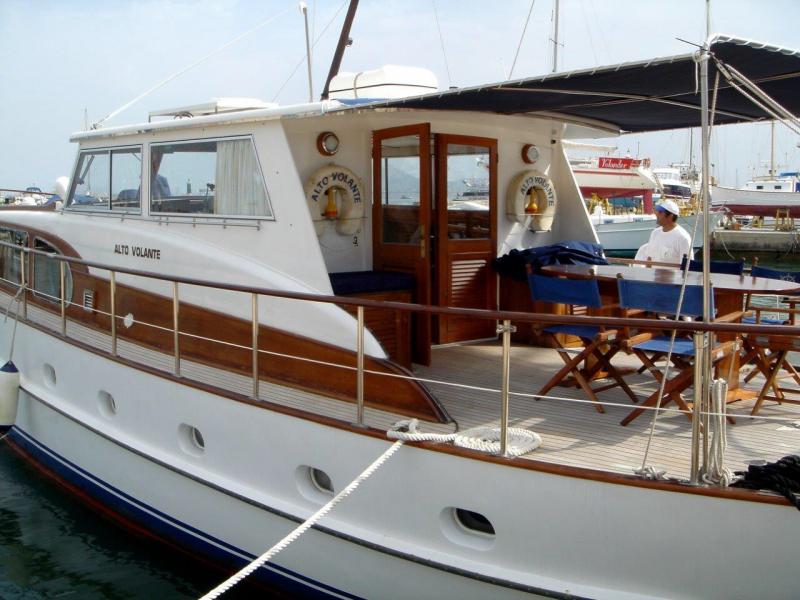

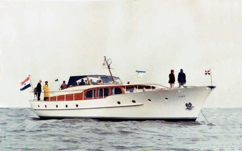

    Originally, ie as launched she didn't have a PH ...

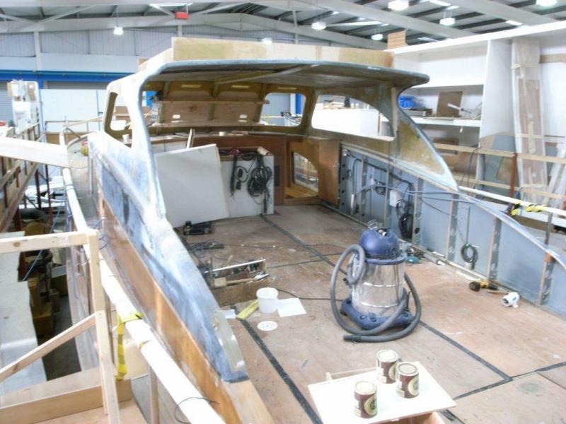

    Tiky
    Then, in the 1980s she had a very boxy PH added. The decision as to whether or not to keep it was made for me when it turned out to be rotten as a pear.

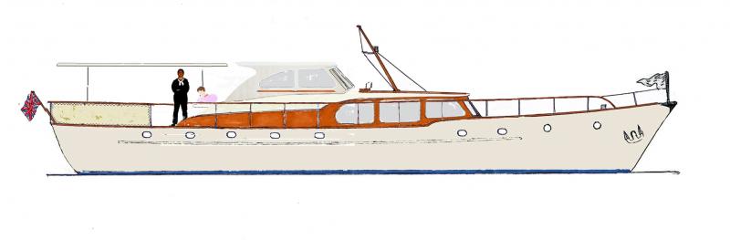

    And this is my original drawing

    Tiky

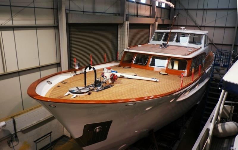

    PH in build
