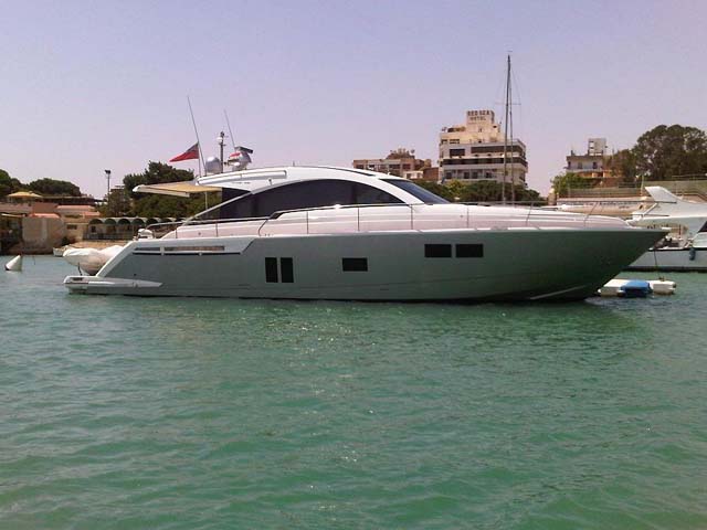

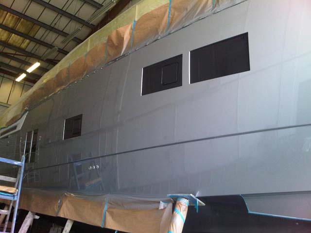

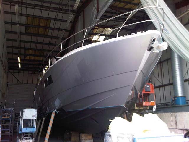

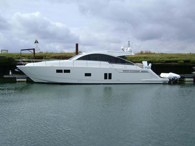

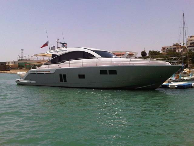

    Thank you for all the suggestions and advice. We finally went with Alexseal paints. The result and the quality of the paint job are fantastic. The technical manager of Mankiewicz UK personally followed up on the paint job. The boat is now in Egypt.
    I am posting some before and after pictures.

    Your boat look really good now TK. All white is sometime to much.
