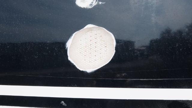

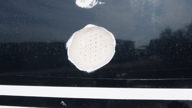

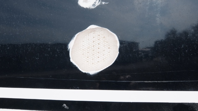

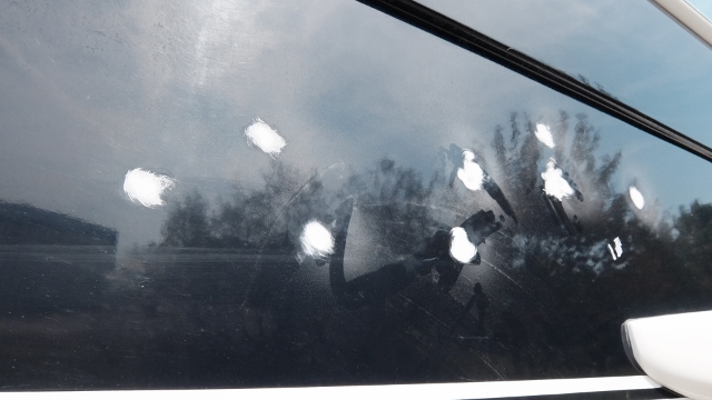

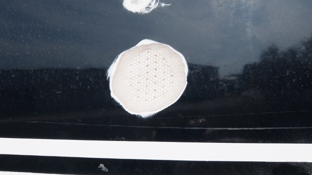

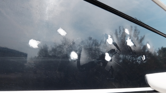

    In addition to the repair concerns, going to a darker color must be carefully evaluated. Darker colors will increase hull skin temps in hot sunlight and can cause print (glass pattern showing through) that wasn't there before in solid glass hulls. Higher than intended heat in cored hulls can be even more of a problem, in extreme cases can cause delamination and skin failure. Many builders specifically exempt warranty on hulls painted after the fact with darker colors.
  5. Bill106
    Bill106 Senior Member
    Jan 9, 2010
    390
    Beaufort NC

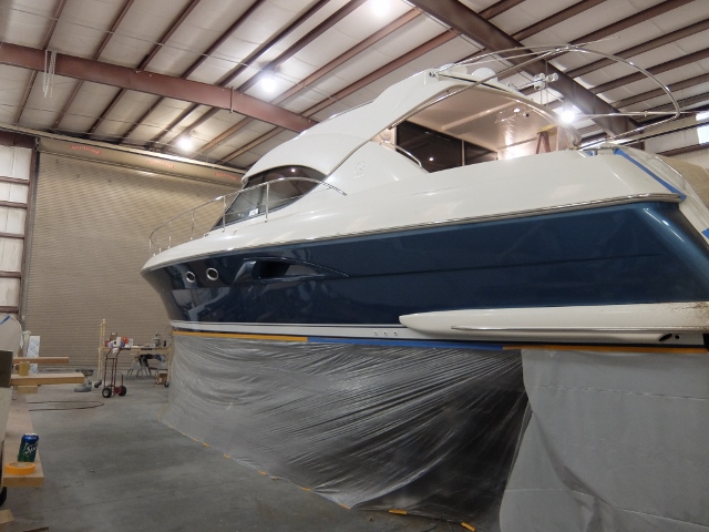

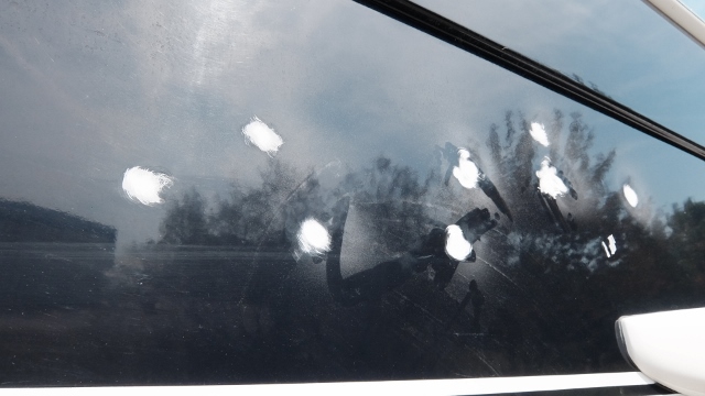

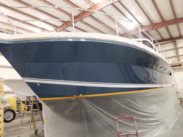

    A case in point on darker (and metallic) colors. This hull was painted Flag blue and experienced blistering on the side normally facing the sun in her slip. The blisters when ground down showed air voids in the core that likely expanded causing the outer skin to delaminate and was not deemed a warranty defect but attributable to the dark hull color. After repair the areas were painted black and allowed to bake in the sun to completely cure then she was repainted with Alexseal Palma Blue Metallic base/clear system. She's now been the South Florida sun for over a year but I haven't heard any reports of further delam or print (no news is good news?). The owner, who I won't mention without permission, is a fellow Yacht Forums member, maybe he will chime in and give us an update.

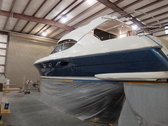

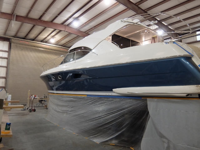

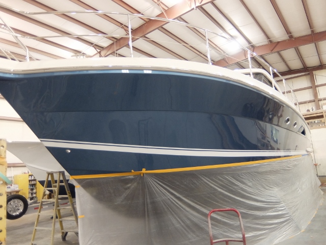

    Well .....for the first time ever ..... I'm going to disagree with Bill106. I'll add some context:
    1. I'm the current (and 2nd) owner of the boat.
    2. Prior to my purchase, the boat was seasonally located at a slip on the Finger Lakes in upstate New York. The boat had a bow south orientation in its slip. Accordingly, the port side (where repairs were made) received the least amount of sun. Further, the docks and adjacent boats were tightly co-located, so the side of the hull that received repairs, must've received a minimal amount of sun exposure.
    3. Upstate New York is a lot different than southern Florida. Northern boats get put away for about seven months per year.
    4. Based upon the above, I'm convinced that sun exposure had no impact on the blisters that Bill106 repaired.
    With the above being said, I can tell you that Bill106 did a spectacular job of repairing the defects, and painting the hull side. The Palma Blue metallic paint by Alexseal continually draws positive comments, as does the quality of workmanship by Bill106. When it's clean, I get daily comments on the metallic color ... it's unique, and attractive.
    That said, if I had it to do over again, I'd probably select a color closer to metallic silver. The Palma Blue is gorgeous when it's clean, but there's no doubt that you can see salt spray after an offshore trip.
    First world problem.

    I believe that Bill was bringing attention to members who are considering re- painting their vessels a dark color and that they should be very careful and research their vessels construction prior to changing color. Older polyester resin vessels constructed with solid or cored hulls can have the problem of "resin float" in the outer two mils of mat/resin due to surface temperatures exceeding 240 degrees in direct sunlight on a Jett Black vessel. This softening of the outer resins will allow fabric print through, delamination issues and fairing compound failures. The problem isn't necessarily restricted to polyester as some vinylesters have had similar issues along with osmosis. Data from early polyester Corecell vessels of the late 80's to mid 90's vintage will prove this true. Epoxy resins are found to hold up to higher temperatures and is the go to for modern composite panel manufacturers. Air conditioning upgrades should also be a consideration when going to a dark color due to UV absorption in lieu of reflecting as a White of lite colored hull will do.

    Thanks for the report (and correction!) Mark! Good to hear she's holding up in that hot Florida sun AND that you're putting in some sea time on her.
    As I'm sure you know captholi, there are "special purpose" epoxies that are formulated with higher HDT's (Heat Distortion Temp's) which we did use on Mark's boat knowing the color. The AC upgrade is another very valid consideration!
