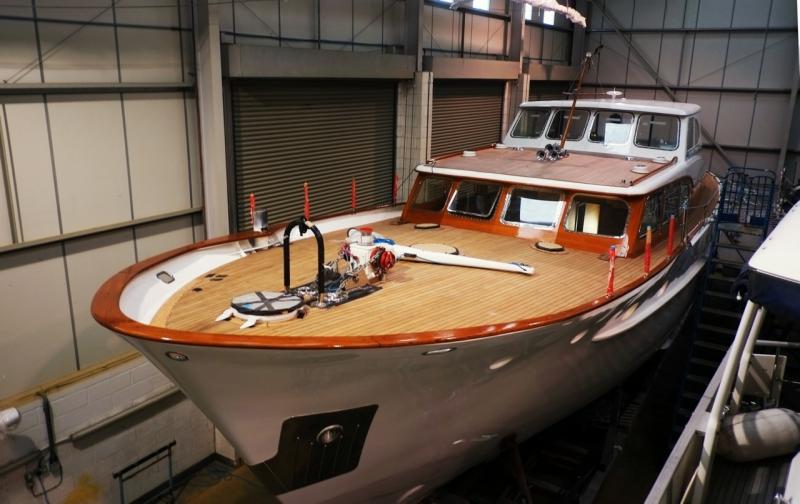

  12. david_japp
    david_japp Senior Member
    Feb 7, 2005
    369
    london
    Varnish caprails on vintage Feadship TIKY ex Alto Volante
    Here is TIKY with the caprails coated with Coelan
