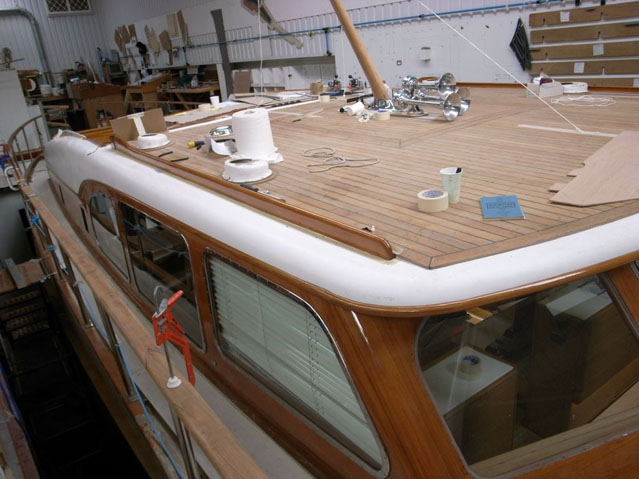

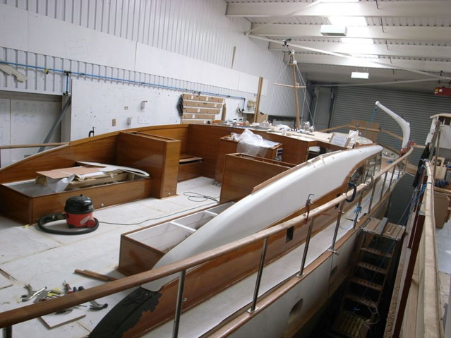

    I'm soon coming to the end of the 5 year rebuild of my 1961 62ft Feadship Alto Volante (soon to be renamed with her original 1961 name but with a slightly different spelling, being "Tiki" instead of "Tiky". Next spring we will move her to the Mediterranean.
    We are using Epifanes traditional oil based varnish on all exterior teak surfaces and Im wondering what is the best way to protect the brightwork from the Mediterranean sun (and winter winter) , especially as there will be long periods when we wont be aboard to maintain the varnish on a daily basis.
    Of course, one way is to have removable covers but they difficult to make and fit, especially on the bulwark cap-rails as they have to have openings for every stanchion and mooring bollard etc . Does anyone have any ideas?

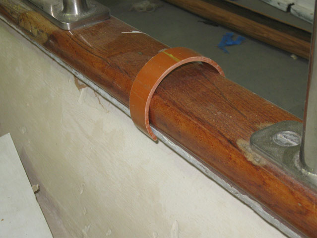

    Hi guys - we've already started using Epiphanes so changing now to another make will be a problem - we have thought of fitted covers for the capping but there is a lot of it (handrail and bulwark..ie 4 x 62ft so 245ft in total at a cost of $4000 for capping alone) but the problem is that she a steel-hulled vessel so fitting pop-catches to keep covers on the capping isn't an option for the bulwark capping. Handrail cover is easier to fit and could be lashed or have Velcro . We may have to use use cut-up sections of plastic down pipe as clips ...not pretty but will at least keep covers on .

    a Labour of love indeed - she s been totally rebuilt inc new interior , new deck, new PH , new engines , new wiring & systems etc etc etc and approx 30sq mt of hull plating ! Ill be posting pics over the next couple of weeks
