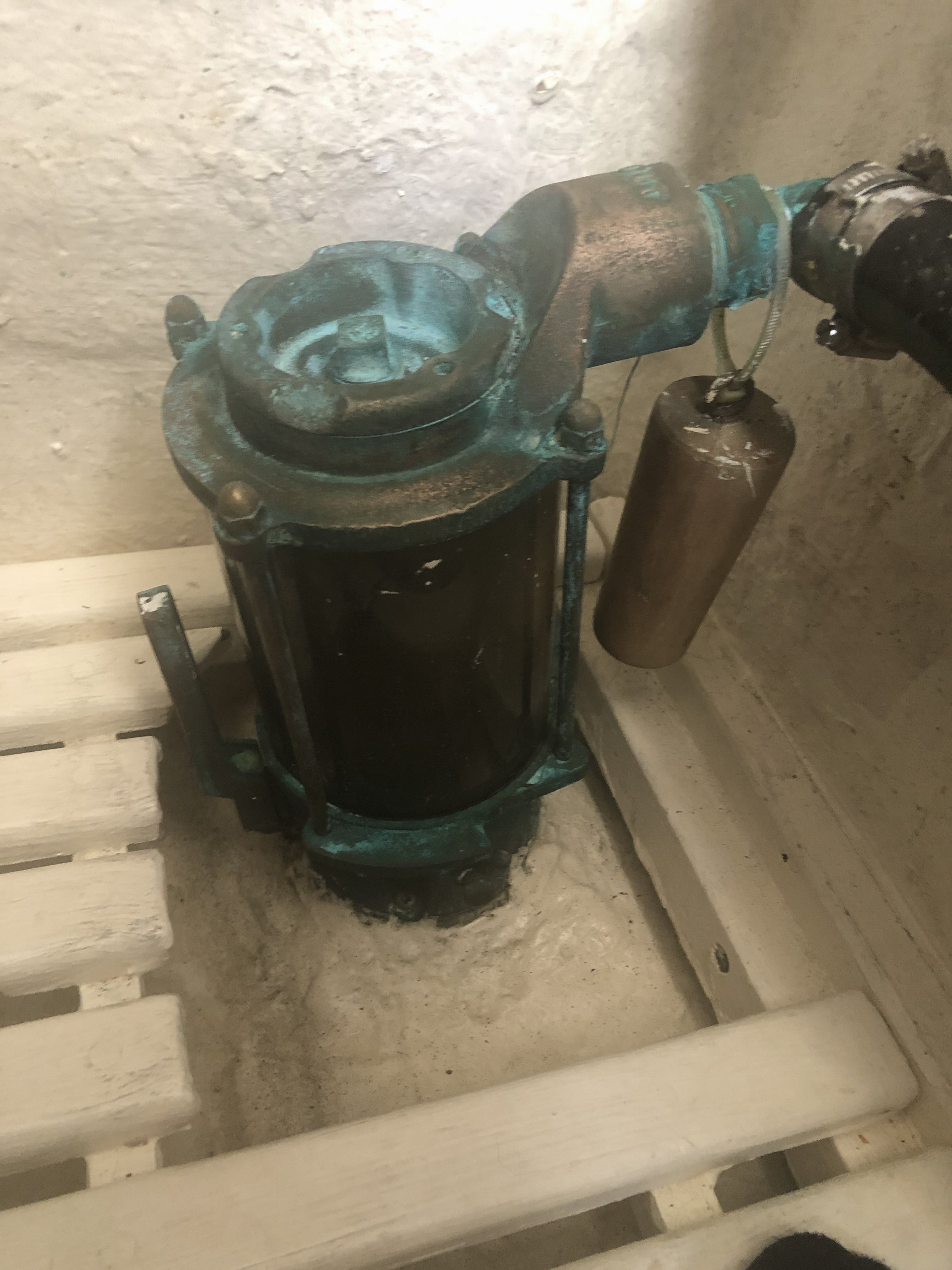

    I like to hide in my engine room and clea, detail and paint. I noticed my strainer assemblies are looking pretty old and nasty. The casting is a rough surface. Any magical way of cleaning them up?

    Brasso? I got that free at Parris island. Remember the smell fondly. I will give it a try. Thanks

    It s normal for bronze to turn green. But if you have nothing else to worry about, good for you :)

    As long as you can open for the strainer and open and close the seacock handle you look good to me.

    I used to apply ON/OFF Gell with a chipping brush to all that brass and bronze, in and out,, AND run like heck.
    The fumes will affect you.
    An hour or more later, wash off with water. With water, scrub all clean with a toilette brush. When dry, do it again.
    The bronze will turn yellow/gold. Seems to build it's own skin and look good for a long time.

    Taco Bell hot sauce works too.

    Make a paste with vinegar, salt, and flour. Apply it to the bronze strainer with a brush and let sit overnight. Clean with a wire brush and freshwater, coat with Corrosion X. Spray Corrosion X on it occasionally and you will not have to clean it again. Never have liked that patina green bronze appearance, even though it usually is not a problem.

    Bronze is an excellent metal that may be polished to be super shiny, resembling brass.
    These parts were abrasively polished, using woven pad wheels and discs using either a straight air grinder or a right angle air grinder.
    On my boat I kept some parts bare and highly polished. Other parts were painted with Pettit 6455/044 Metal Primer, then Interlux 2000E Barrier Coat Primer, then Rustoleum Professional High Performance Aerosol Spray Paint.
    The painted parts have retained a glossy plastic appearance for well over a decade.
