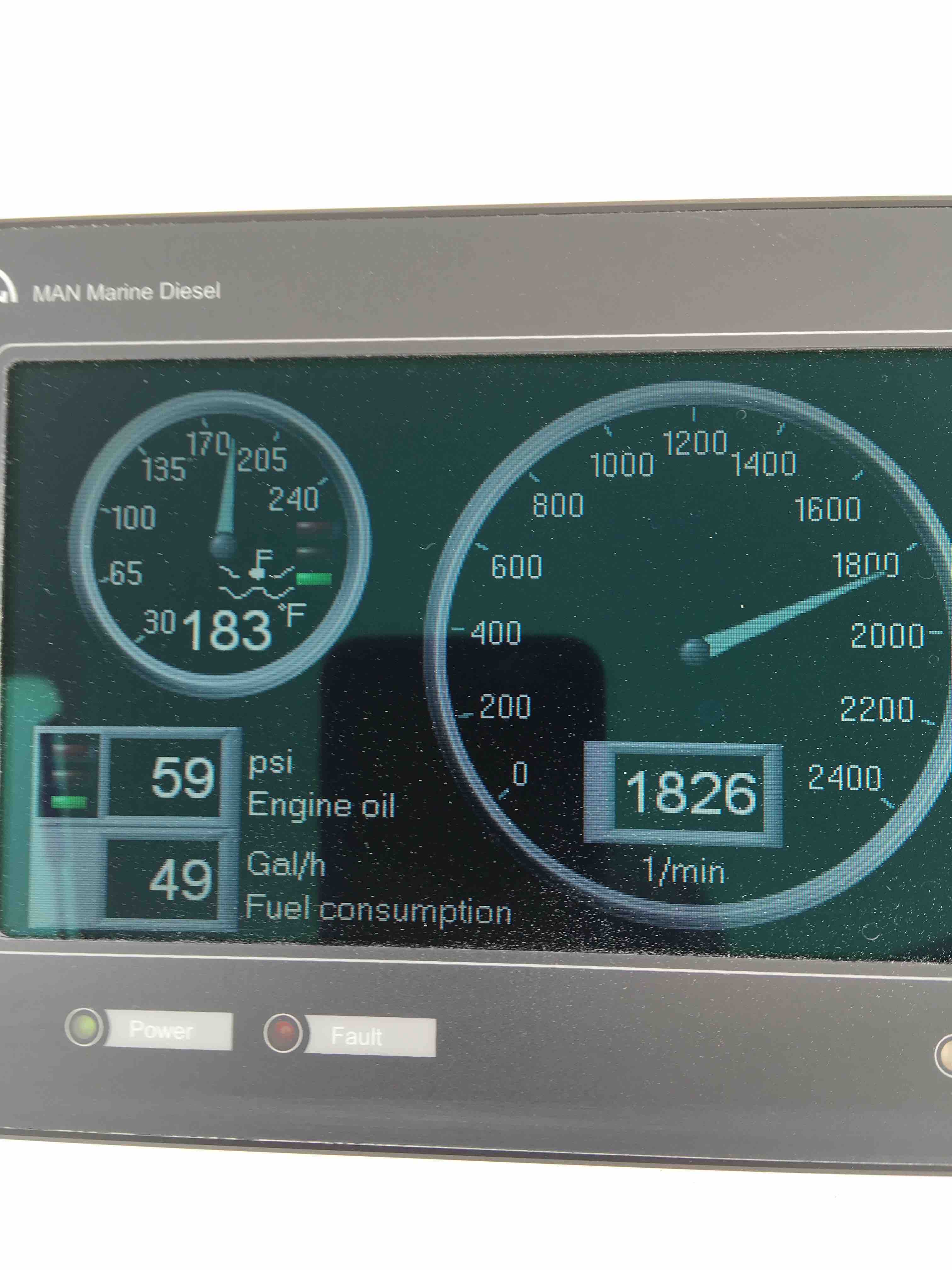

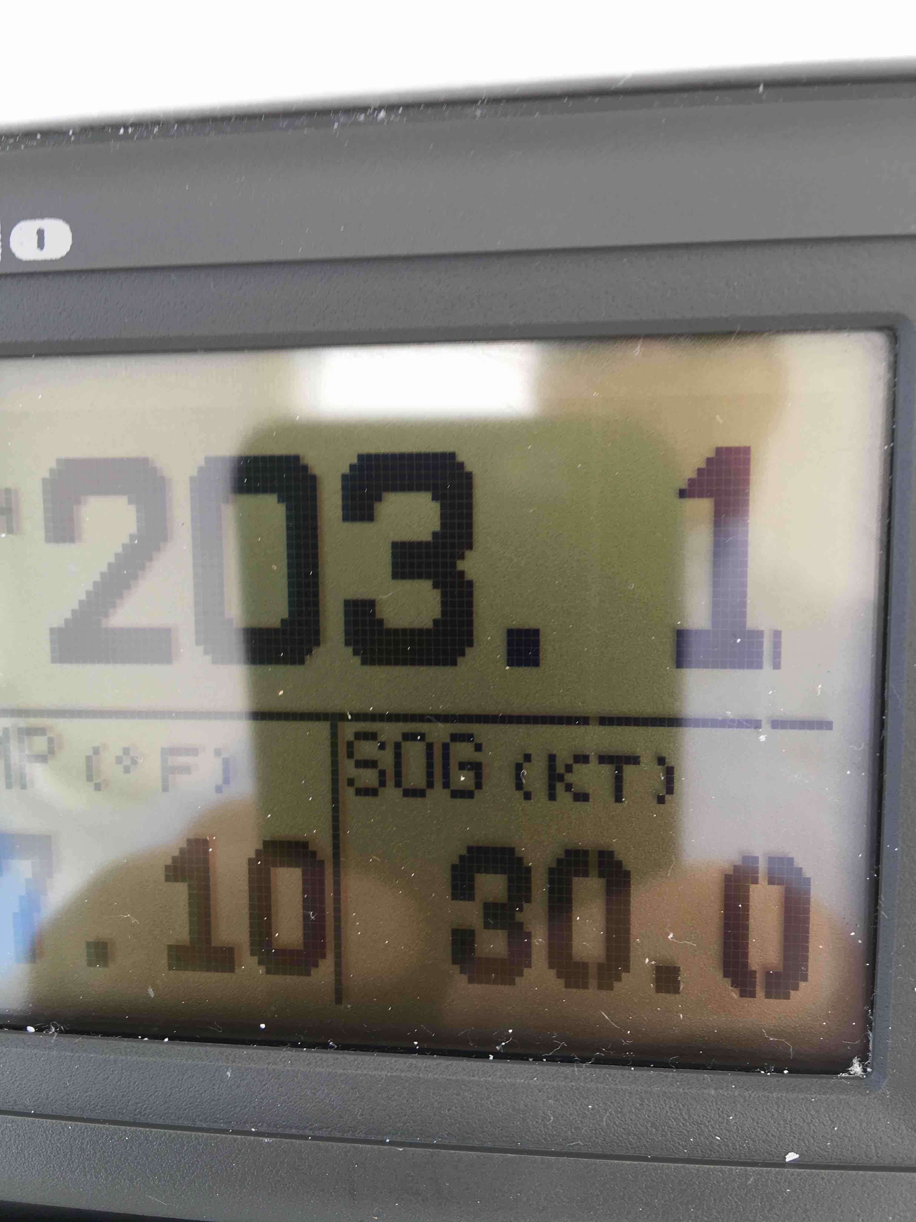

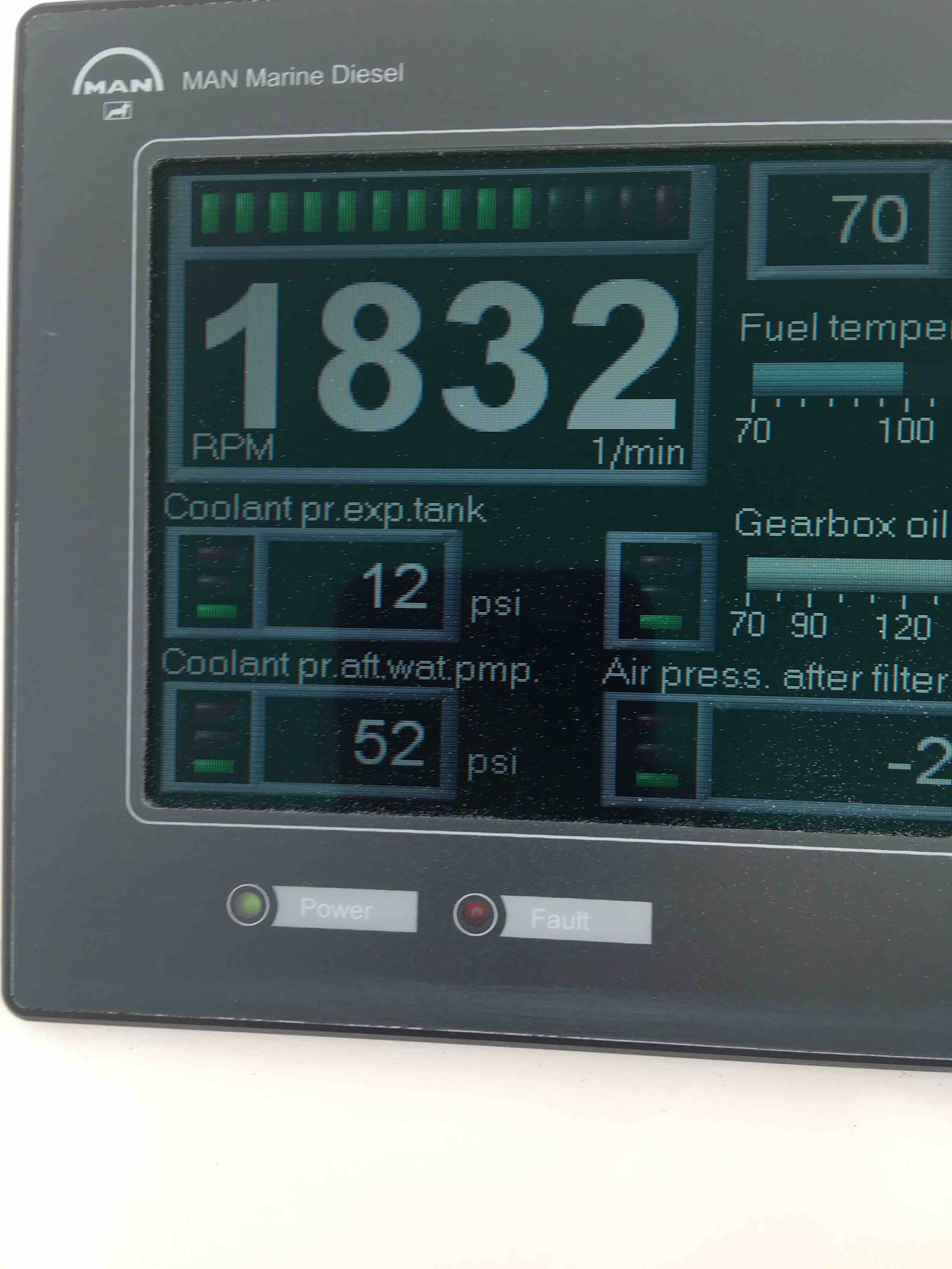

  3. BoulderGT3
    BoulderGT3 Senior Member
    Jun 19, 2014
    168
    Ftl
    some pictures from today. I was only 1830 or so but it only goes up a degree or two to 2000. Skip, I also put a shot of the pressure too. I tried to show water temp but it clipped. It was 87.1.
  4. CSkipR
    CSkipR Member
    Aug 16, 2008
    965
    New Smyrna Beach, Fl
    Tom your engines definitely run about 7-9 degrees cooler than mine. Nice 30knt cruise at 1826rpm although I like my 60 gph better.
