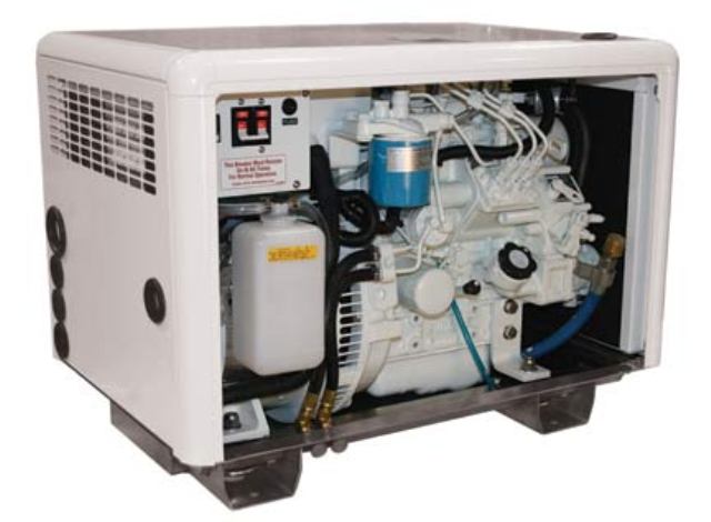

    Below the Northern Light sound box with the 5 KW Genset. Note the air gates and the relatively big 3 cyl. Diesel engine. Weight including box is 421 lbs.

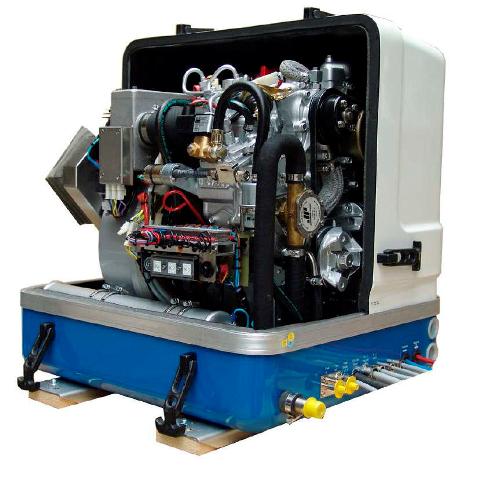

    The Fischer Panda AGT-DC 5000, variable speed 5 KW Generator for example produces less than 60 db in the engine room during peak RPM and load and app. 55 db in the average. He is only less than 2 ft in length, width and height and has a weight of app 300 lbs. He is automatically started and stopped by the battery watch module and most likely will run only two times 1,5 hours a day, to keep the batteries alive. You will not hear him in the salon above at all. May be 2 sec. of very light vibrations, when he (cold) starts.
    I have a bigger version of this type of Generator as a Stby and night Generator in my large sail boat. My engineer and me and my guests love him.
    The Fischer Panda AGT-DC 5000 uses a little 0,5 Liter 2 cyl. Kubota engine and the liquid cooled FP DC 12 Volt or 24 Volt alternator. With the above mentioned usage, may be 1 gallon or 2 of diesel a day.
