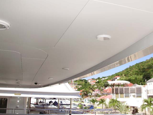

    I am hoping some one out there has a good idea for a simple problem. These over head light fixtures have the top piece that screws off and then gives you access to the lamp. The problem is that some times they do not screw off easily and make a 5 minute job very difficult and long. I would like to just take a big chain wrench and twist it off! But a lot of people get upset when you make big deep dark marks on the pretty white paint.
    Does any one have any bright ideas on how to unscrew these fixtures with out causing damage?

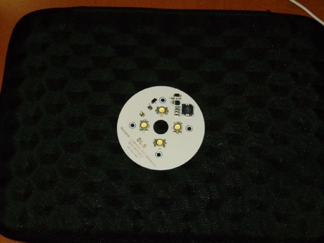

    That's not a bad idea, but first they have to figure out how to make these fixtures water proof. The lights in the pictures are LED's which should be lasting 30000 hrs or some stupid number. Problem is when the deck crew washes down, water finds there way in and shorts out the little circuit boards. Funny how I can't twist half of them apart but water still gets in.

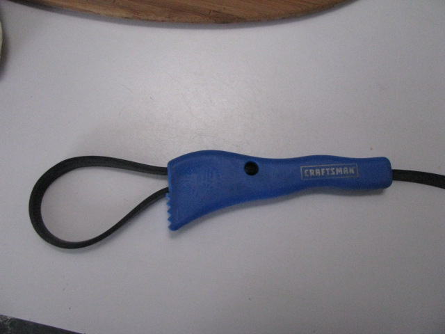

  13. NYCAP123
    11,205
    When you can't find the right tool it's time to make one. However I think the jar opener should work if you can get enough grab. If not, this should work without maring. IMG_2452.JPG The handle is 6"

    These LED lamps really do not like water. They are soldered in as well, not like a nice easy screw in and out deal.

    If water is truely the reason they are burning out like CaptJ suggested a dielectric coating over the electronics may be a cure. That can be anyting from a paint on liquid electrical tape (Look for the opaque stuff not the black) or spray on dielectric products,CRC makes some good ones.
    A solution from the manufactuer could be to put the entire disk in acrylic,there is enough heat disapation for the electronics while keeping them water tight. Done right the acrylic could act/replace the lens so you only have a single disk ,like a hockey puck to replace. You still will have either spade terminals or 2 wires sticking out,where corission can cause problems. Heat shrink works well.
