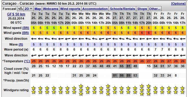

    Just to be sure, below the figures for Curacao this week, 5ft Sea and 6 seconds wave period.
    Correct me if I'm wrong, with this sea I go out without any problem.
  19. NYCAP123
    11,205
    Better make that 6-9 seconds apart. 4'/4 seconds or 7'/7 seconds will not be enjoyed. The rule I've learned works is minimum of 2 seconds over the wave height up to 10' (4'/6 seconds- 7'/9 seconds). Over 10' all bets are off, but up to 15' I'd want at least 5 seconds over. Biggest I've gotten caught in I'd estimate at about 18' in a 43' SF, and I never want to be there again.
  20. RT46
    RT46 Senior Member
    Feb 22, 2011
    1,058
    NYCAP.
    your right.
    that is what i was thinking but somehow it came out wrong when i typed it.
