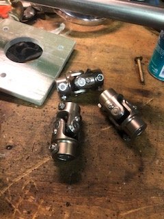

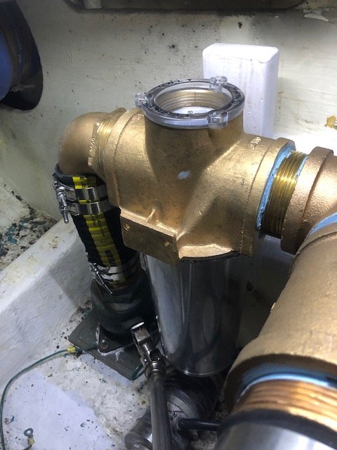

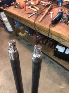

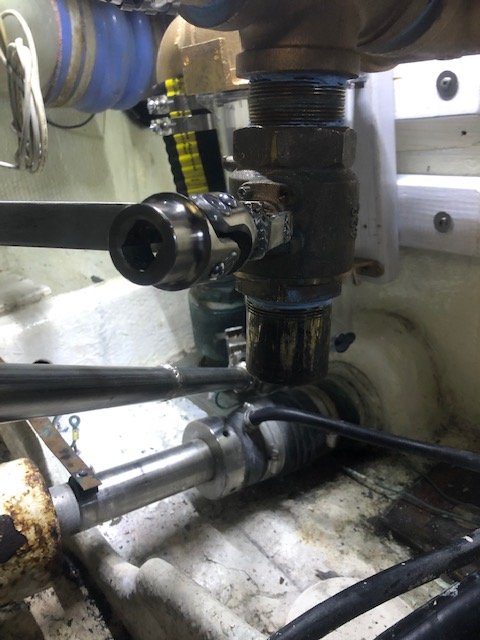

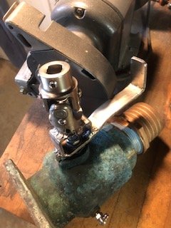

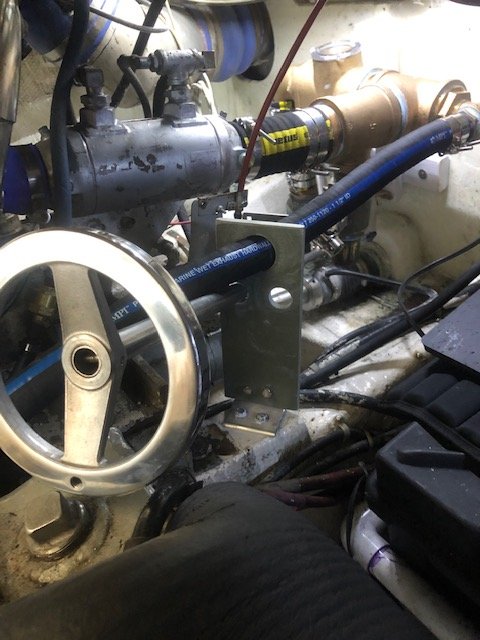

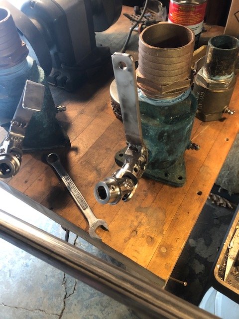

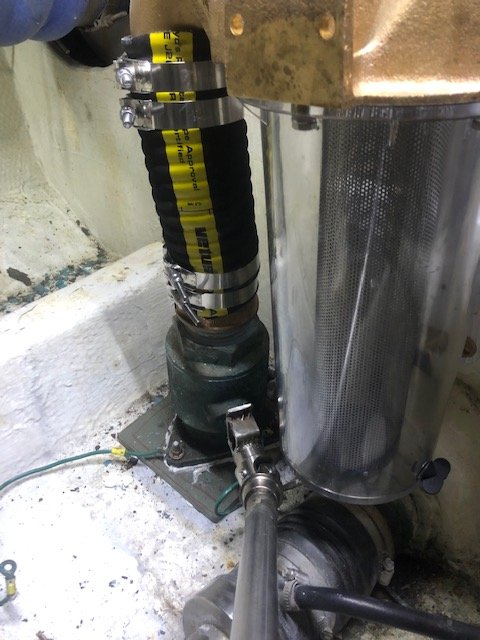

    I was going to start a thread about this but you guys beat me to it. I noticed this problem early on. Having worked in the maritime industry my whole career the logical answer to the problem was reach-rods. Whenever a valve on a ship or tug is in a bad location that's hard to access it is usually connected with a rod which relocates the valve handle. One project during the winter shipyard period was constructing these. I used 1" stainless tubing from McMaster, and some aluminum valve wheels off eBay. Because of the angle of the valves themselves it was necessary to incorporate universal joints so the rods could angle up next to the inboard side of the engine on each side. These I found in the form of stainless steering column joints on Amazon ($36) I welded these to some square u-brackets I made out of stainless flat stock, then to the valve handles themselves. I've test fit them and made some adjustments to the length, just need to finish making a support bracket for each near the handle end.

    I'll put up some more pictures once I finish the install

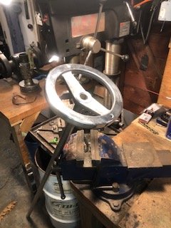

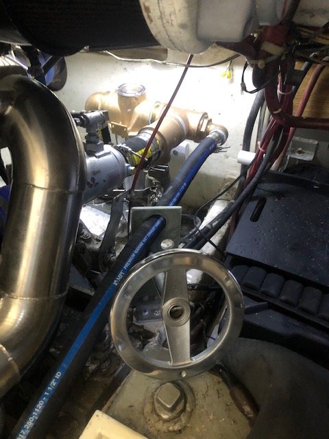

    So I promised more pictures when I finished the project. She's back in the water ran great from Lindenhurst to Freeport. Huge thanks again to Rich M for acting as pilot though the marshes that they call channels out here.

    Oh come on now the run from Lindenhurst to Freeport isn't bad once the buoys are out. lol. (Are they out yet?) Seriously though that wheel is your seacock activator? Very cool. Never seen anything like that on a smaller boat. I'm impressed.
