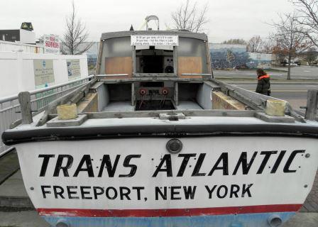

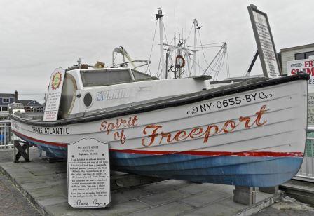

  14. RT46
    RT46 Senior Member
    Feb 22, 2011
    1,058
    Al Grover did it in this boat:
    lots of stuff online about the boat and the crossing.
    The boat is on display in Freeport NY

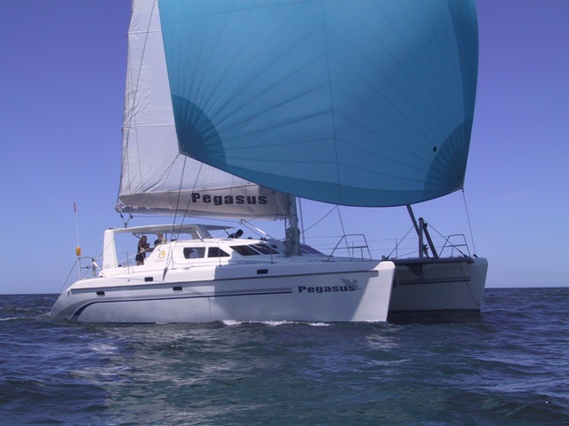

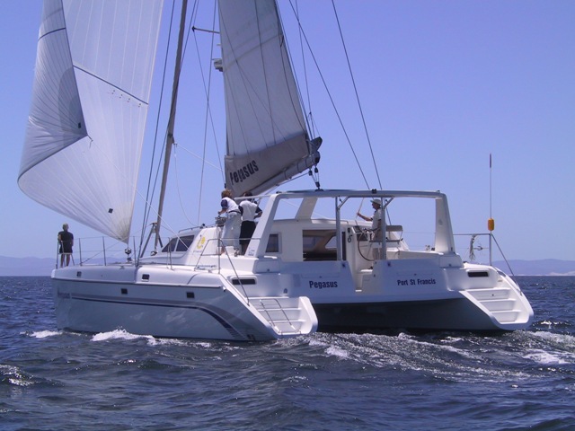

    Catamaran sailing yachts in that size are a pretty rare species. They require some crew to handle and are quite expensive to build. And most of the (french) production catamaran yachts with the internal volume you want, like the Lagoon 560 or 620, the Fountain Pajot range or Catana catamarans are boats for warm climates and nice weather. And their build quality and usefull lifespan cannot be compared with anything like a Bering yacht or other long range trawler (steel or GRP). For exploring the harsh enviroment of the (northern) Atlantic, you need something more beefy and with more protection for person on the wheel and especially when used as a live aboard. And any harbour master and lock operator around the atlantic will hate you because of their beam :).
    With the budget for a 30 to 40 meter steel or GRP trawler or long range explorer (preowned or new) you have a whole world to choose from. If your name tells me, you are living in the BENELUX area, you live in the middle of that yachting industry. Names like Moonen come into my mind. Or just contact Vripack Naval Architects in Sneek (NL). They have tons of ready to build plans for long range trawlers and yachts, which have been built before or they have the local yards on hand to start a project. Have a look at their portfolio, they show all plans.
    If you are located on the other side of the pond, Bering or IMHO Nordhavn are good names to talk to. Both companies build in China anyhow. And if you are looking for a preowned, most of the above mentioned boats are available on the second hand market.
    If you could specify your ideas a bit more, this forum will fill you up with ample of great advice and info.

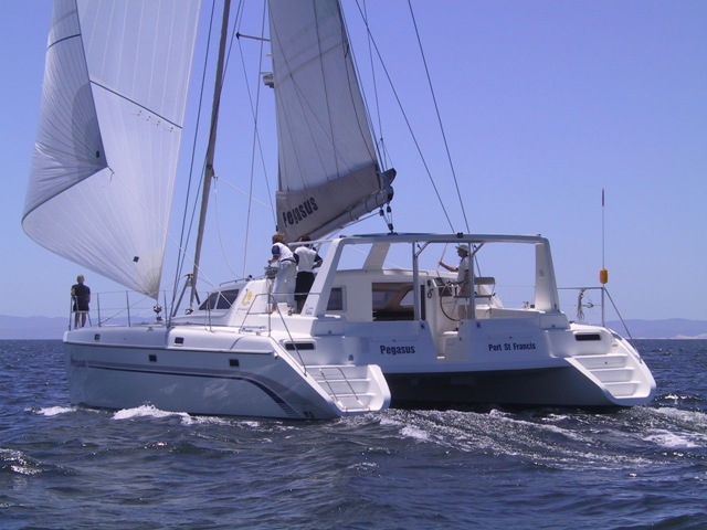

    But if I misunderstood your question and you mean a 30 to 40 ft boat, there is a very beefy 48/50 ft catamaran available on the market. The South African build St. Francis 48 or in its newest version, the St. Francis 50. This is in my opinion the most seaworthy, highest quality, all weather catamaran with the volume an loading capacity you want, available on the market. It can be safely handled by a crew couple and is by far cheeper to operate for a normal mortal boater.

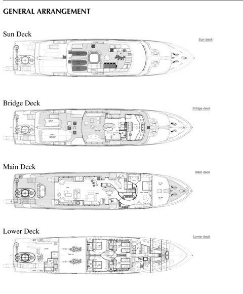

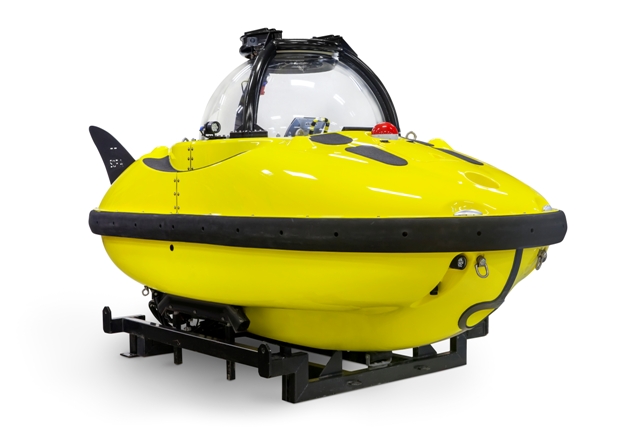

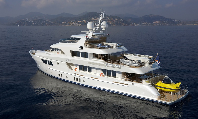

    With the type, size and weight of your planned tenders, a catamaran must be quite big in order to safely accommodate and handle safely such "toys". We operate research, offshore and support vessels with ROVs and subs. This is business for professionals. To safely hoist (deploying and getting back on deck) a sub or a larger tender, you need a stable platform and beefy lifting gear plus professional crew. A 40 meter one off catamaran is a giant and may require a crew of 8 to 10 and may easily break the 500 GT border. Beyond that gross tonnage, we are talking about very expensive regulations and operating costs. I would rather forget about a catamaran for your planned use. An existing large monohull sailboat (40 to 45 Meters) could be converted to carry such toys. Several larger sailboats usable for that purpose are available on the second hand market.
    The minimum boat for your needs is something like this:
    The Moonen yacht Sofia. A similar existing yacht of this size could be converted for your needs. Converting a preowned commercial trawler could also be a possible approach. 1.000.000,-$ is a pretty good anual budget for a good sized yacht.

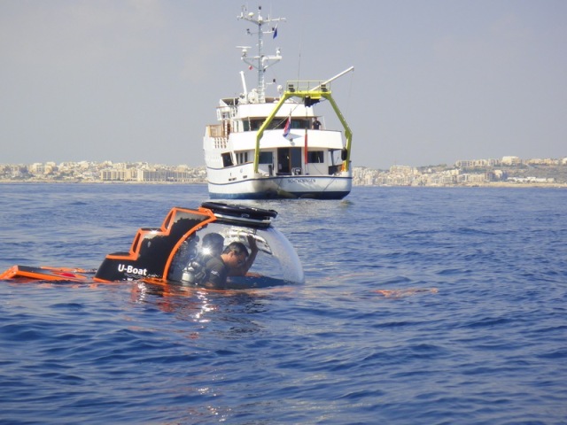

    I have personally seatrailed the Deepflight Falcon and 2 different Uboat Worx type subs. We have decided for the UboatWorx sub as the separate cockpits of the deepflight falcon and its sister, the dragon have and will again, cause claustrophobia with unprepared passengers. A passenger will feel much more comfortable, sharing the compartement with the operator and / or other passengers. And the UboatWorx type can be equipped with remote controlled manipulator arms and other options. Do yourself a favor and personally seatrail both types. A lot of money can be spent on the wrong sub.
    My personal advice would be: Go for a powered exploreryacht with a larger tender deck and appropiate lifting gear and seatrail the Sub prior purchase.
