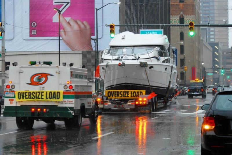

      72.9 KB
      6,567

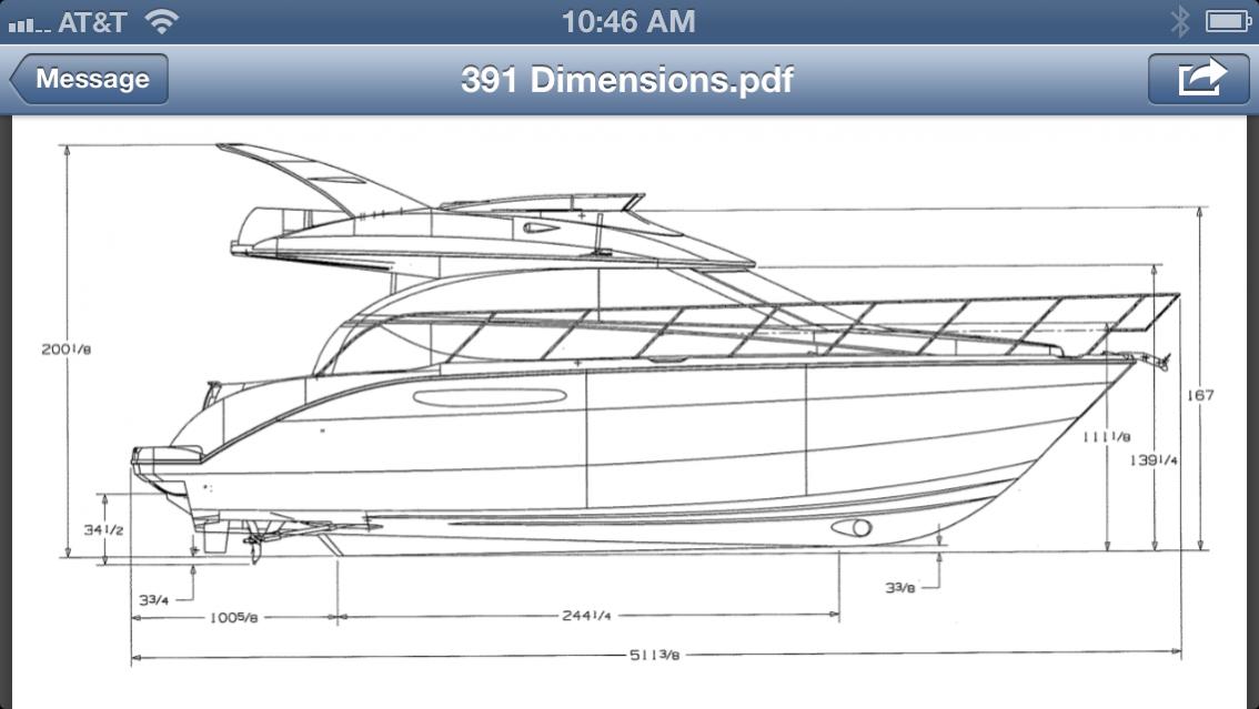

    Boat dimensions
    Below are boat dimensions that show the parts components that I would need to remove. It looks like I would have to remove all parts above 139 1/4 " to get down to legal height. The picture of the 39 going down the road doesn't seem to have the fly bridge removed. Maybe it was only for local travel.
