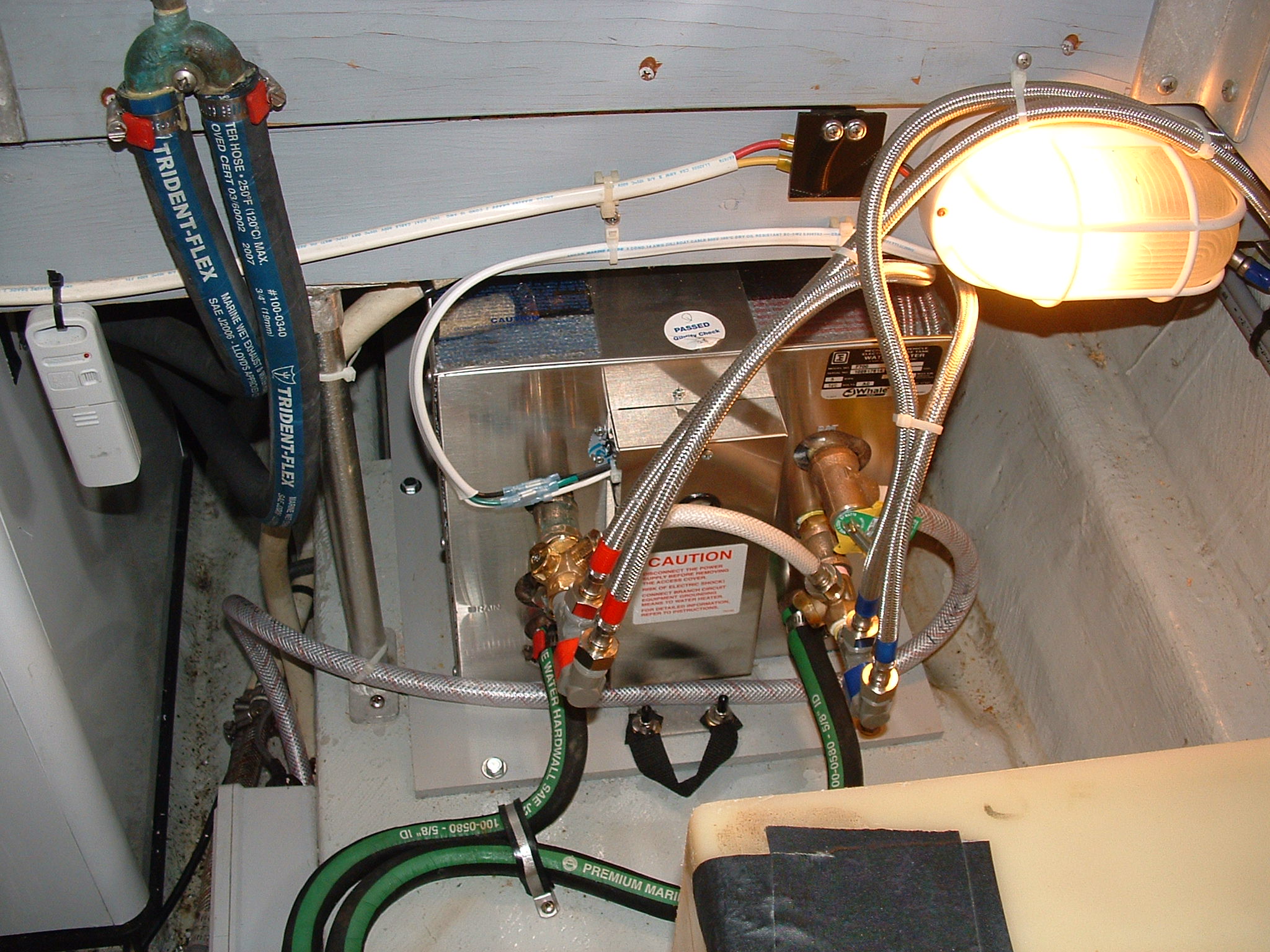

    Thinking it could also be the pressure relief valve leaking, which as I recall on my 94 Luhrs, was also on the backside of the HW heater. If you can reach around and exercise the handle on the valve, it may possibly close. You might need an extension mirror to see behind the heater. In any case this is not an ideal situation, so if you must remove/replace the HW heater, my recommendation is to get a hot water heater with all the connections on the front side. Everything is more visible that way, and it makes winterizing much easier with the bypass kit. Here's a pic of my replacement HW heater, with the water connections, and engine connections all on the front side. I needed to extend the original water line connections from the back to the front of the heater (these are the braided hoses in the pic). Also mounted it on a piece of Star-board to make for easier slide-out removal after disconnecting all connections.
    Hope this helps you!
    Kevin
  4. NYCAP123
    11,210
    I see you even have a strap for pulling it out. Nice, well thought out setup.

    Yeah, the Pressure relief valve is facing front along with a drain valve, neither is the culprit. Problem is the water connections are on the back and they are inaccessible. Will definitely reconfigure with all connections on the front. Was just wondering if anyone ever dismantled the cabinetry...looks like a bunch on internal mounting screws that connect the panels which need to be removed to open up access. Will have to be an early winter project, not going to let this get in the way of stripper fishing!! Thanks for the post and pics...great forum!!!
