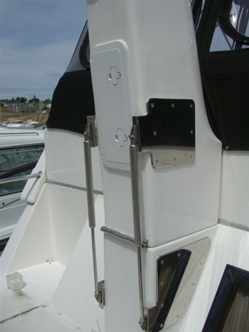

    I am considering buying a 423 Classico with a hinged mast. My boat house requires that I drop the mast due to height limits. Does anyone have photos or drawings on how one actually drops the mast. Is it too heavy with the radar for one person to lower by hand assuming you had a rod mounted part way up the mast that can pivot as you lower it? Thanks for the ideas.

    I realize that this is an old question but thought I would respond with my experience. Standing on the flybridge I used a .5" line tied to the radar mount and lowered it that way by myself to some timber blocks I stacked on the lazerette to rest the mast in a horizontal position. My radar is an open array furuno. I was not easy but not impossible. I would suggest that you might want to be at least 200lbs and have somewhat above average upper body strength.
    Like all things on this planet, it is a bit more difficult going down than up. I suggest it is a two man operation, to be on the safe side. Probably using a ratchet winch of some type would be the smart way to do it alone.

    Thanks, Geologydave. I found the solution. I used two 125 pound gas pistions like you would see on a stationwagon back window. I can now raise or lower the mast with one arm. I just had to add mounting plates and backing on the mast sections to mount the pistons to. If you care to contact me, I can provide photos of the finished project. amostad mostad@mostad.com

    I would love to see a photo. Much more elegant solution than my caveman approach. can you post the photo here?

    photo of gas piston for mast
    Here are photos of my 125# stainless steel gas piston. These allow me to raise and lower the mast with one hand on my Ocean Alexander Classico 423.
    You are more than welcome to use this plan. Remember, there is a 1/4 inch aluminum backing plate behind each stainless outside plate. IF you would like more photos please contact me at the email address in the February posting.

    second attempt at posting the photo
    This is my second attempt at posting a photo os the mast lowering pistons mentioned above.

    I saw your solution on Yacht Forum. It is absolute genius in its simplicity! Congratulations. Would you be able to send a copy of the plans and name of the provider of the brackets and pistons? I would be most grateful.
